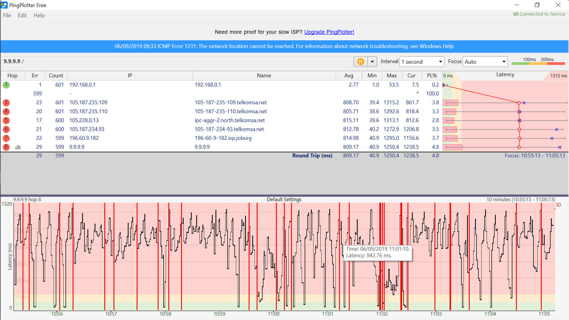

This outside my technical area and I haven't been able to find a similar issue in the forums, so....
I have attached screen grab that shows no information for the hop from the router to the first of the ISPs servers. Well, no information except a lot of errors and packet loss. Whats happening? Thanks - Mike
Lost hop.jpg (276 downloads)
#3463 - 09/06/19 11:58 AM Re: The lost hop - blank 2nd hop [Re: MNUK]
Hey MNUK,
This is a pretty common issue that we see with routers and edge devices - this just means that the device isn't configured to respond to the types of packets we send out. You can see more about this here:
https://www.pingman.com/kb/article/blank-missing-hop-router-2.html
Let me know if you have any other questions!
