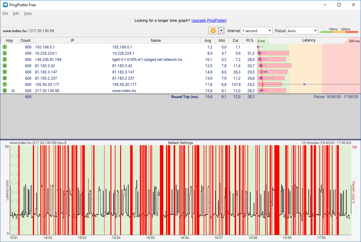

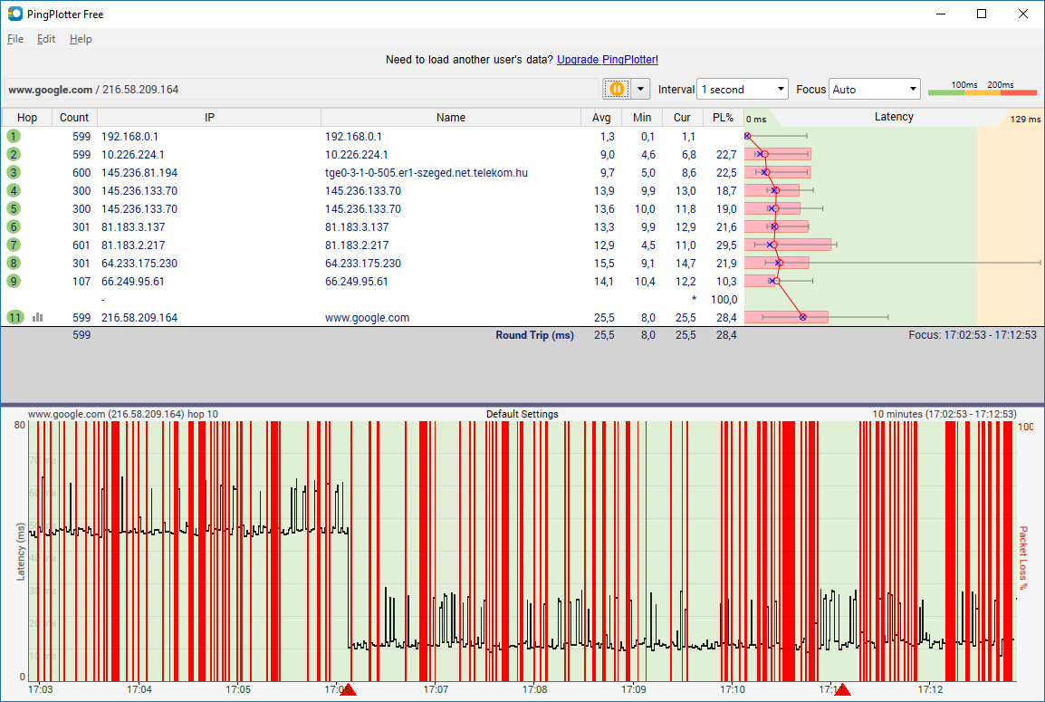

Long story short I'm fighting with my ISP for a long time now but they can't see the issue I'm having even when I've provided them pingplotter reports.
I would like to ask for some help interpeting my resutls to see if I was mistaken, or the ISP is the one who doesn't know what they are doing.
I've attached two pictures which I need help with. First hop is the home gateway, the second one is the CMTS of the ISP. No matter what I ping the packet loss starts to show up starting the second hop. Is it even a packet loss? In the bottom graph it always shows up as a 100% packet loss, so could it be that the internet is cutting off for random periods of times somewhere between the HGW and the CMTS?
Please someone help me telling what could be the problem because it makes my internet unusable and my ISP doesn't want to acknowledge that the problem is there.
Edit: I've added a sample set from today in the hopes that it might be easier to find where the issue is.
www.index.hu.pp2 (891 downloads)
Edited by StealthKid41 (12/02/17 10:16 AM)

I think your case is definitely compelling, and I do see what you're referring to with the extensive packet loss. However, I don't have *quite* enough information to be able to help decipher.
What I'd recommend is trying just a few different options to see the impact. While it does appear that the ISPs router may be the source of much packet loss (telling by the replicated pattern and extensive packet loss carrying through each subsequent hop), it would be helpful if you could leave a consistent trace going to a reliable service (24x7 is helpful, and I always personally recommend a simple Google trace). From here, when you notice an issue, make a note of it, and head back to PingPlotter to try and correlate the PingPlotter data with the symptoms you experienced. Find the packet loss pattern, and try to correlate it with the earliest pattern you can. Here's an article that might articulate this information a bit better than I do:
https://www.pingplotter.com/fix-your-network/interpret-results.html
It does appear that this could get a bit messy, given the results I've seen from your sample set, but see if that helps in interpreting where exactly your issue is.

I looked at your data again, and purely off of the quantitative data, I see a lot of issues starting at hop 2, repeatedly. Now, this data set is from December, but I do stand by what I said. PingPlotter uses a combination of your plain ol' ping and traceroute to deliver results in a graphical way - so if you just had a ping -t going to your final hop, I'd bet my bank account you'll see the same thing as PingPlotter (except ugly, because... command is ugly. That's why we made PingPlotter to begin with).

I get similar results to the December one, but not as severe as it was before and it's limited to the timespan mentioned in my previous post.
You are right about the ping command. I've pinged my HGW and the end destination at the same time, the HGW still showed 0 lost packets, but I got the packetloss at the end destination. Tried the tracert and pathping commands too and those showed similar results.
I've checked the patterns you linked to me and in my opinion it still looks like it's the "Internet Service Provider Bad Hardware" issue, since the issue starts at hop 2 and goes all the way to the designation.
