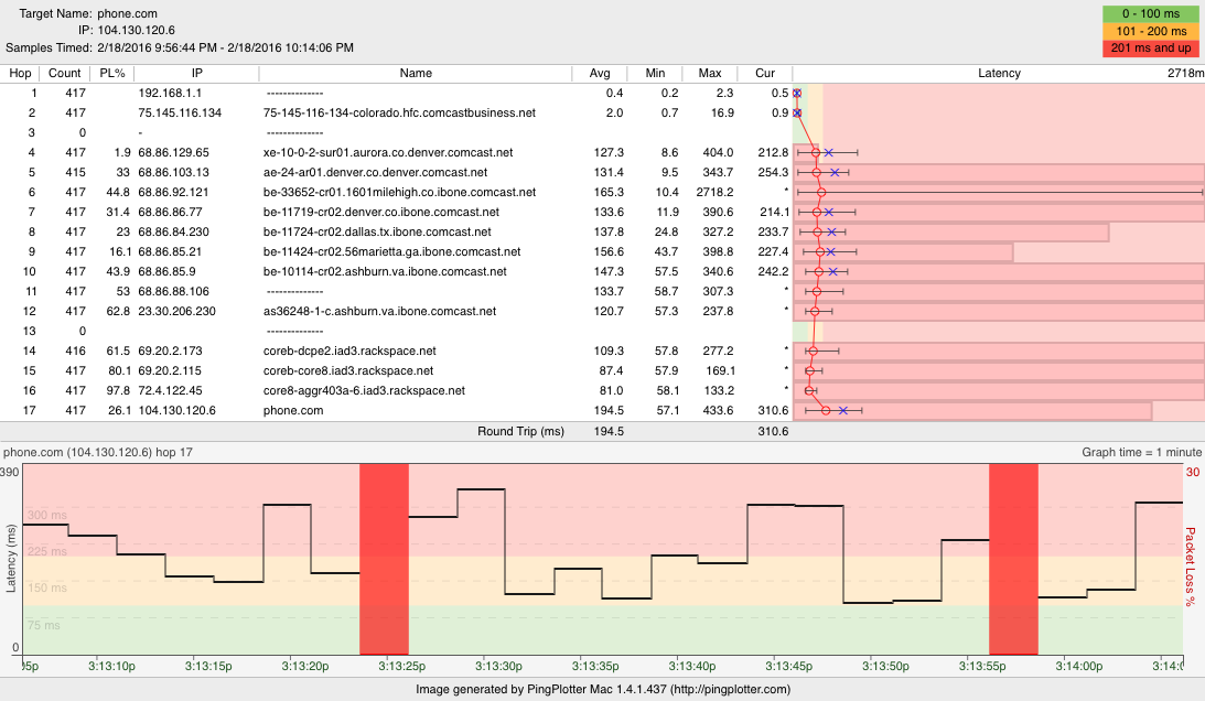

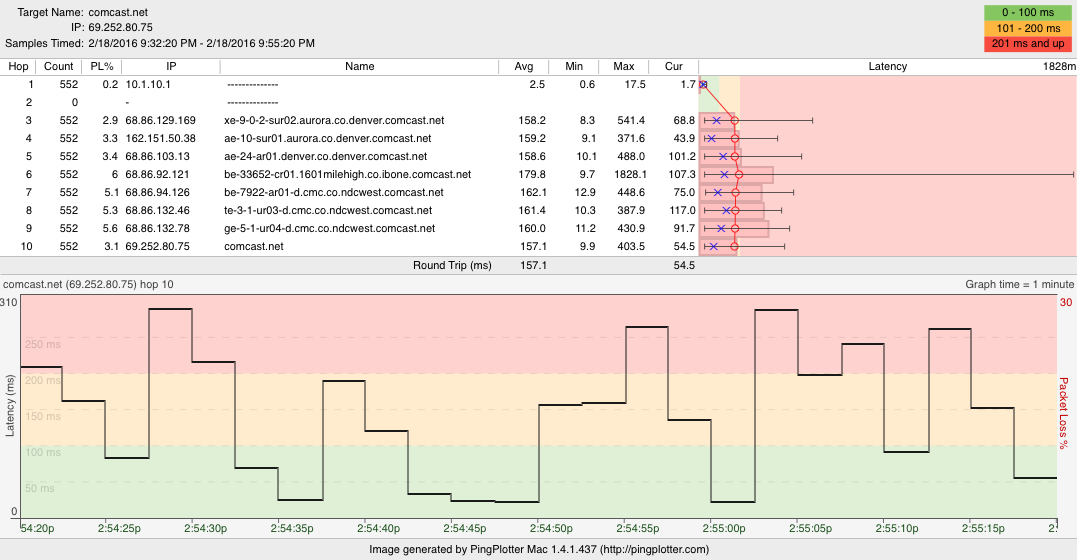

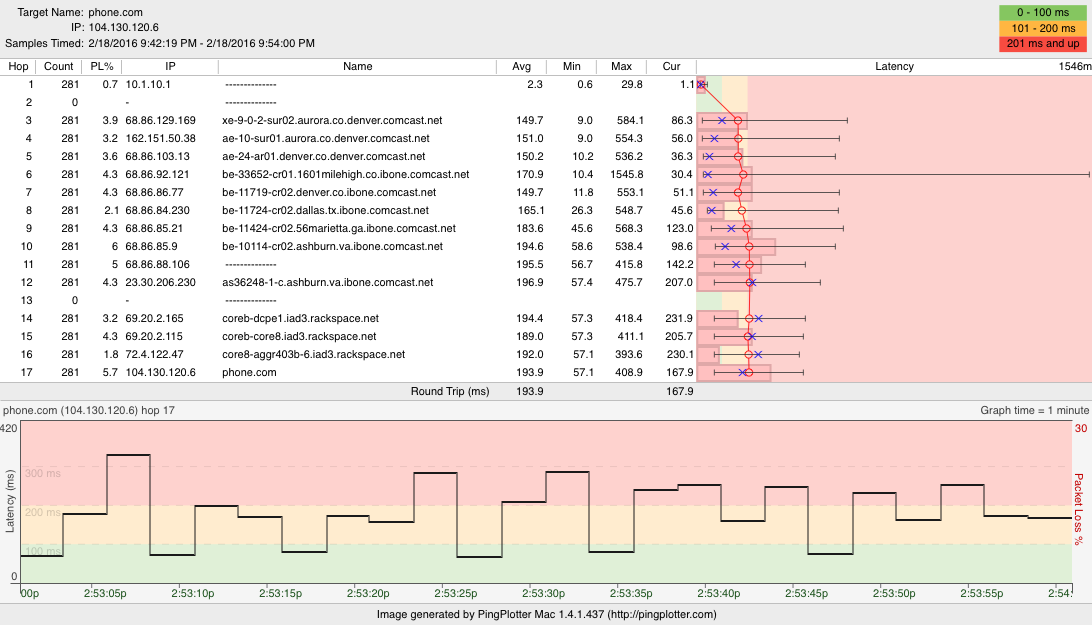

I'm trying to understand my poor VOIP performance. Ping Plotter Pro has shed much light, and what I see in the light has created confusion. For background, my network consists of a Zywall 110 router, and a Zonet gigabit switch. Comcast just replaced my modem with a brand new one. I'm in Aurora CO, a suburb of Denver.
To troubleshoot, initially I pinged my modem at 10.1.10.1. No packet loss and very minimal latency. So it seems like my hardware is OK.
Then I pinged Phone.com, my voip provider of the moment. Lots of packet loss, and lots of latency, that seem to originate a few hops in on Comcast's network.
Then I plugged directly into the modem. Much less packet loss, and still quite a bit of latency, but not much variation in latency. The latency I'm seeing seems much higher than what others are seeing.
It doesn't matter what I ping, this pattern holds. Also, there are 2 or 3 Comcast servers/routers that I hit every time I ping something.
So is it possible that my router is doing something to my packets that is somehow causing packet loss?
Should Comcast's network be better, or is it as good as it gets?

Here are some screen shots:
Description: Pinging comcast.net directly from the modem. Should be best case, but results are not ideal
Description: Pinging comcast.net from behind my router. Notice the extreme lag at .121. It shows up in every situation. Hop 2 is my modem.
Description: Pinging phone.com from my modem. Not great, but perhaps manageable packet loss.
Description: Phone.com from behind my router. This does not work well with voip.

It is really hard to say based on your screenshots (due to only have about 30 second samples), but it *does* look like this is on Comcast's side.
It *does* look pretty similar to bandwidth saturation (as seen here: http://www.pingplotter.com/commonnetworkproblems/#bandwidthsat). At this point, it may prove helpful to continue monitoring for a longer period of time (if you could let PingPlotter run continuously for 24 hours - that would be great). This would allow you to see if the pattern here happens to be time based (do the spikes in latency/packet loss drop during non-peak hours - when no one is using the internet?), which may help provide more clues to what is happening here.
We do also have a great guide to troubleshooting network issues that you may find useful here:
If it is shown to be Comcast's network, this guide will show you how you can prove it to them by building a good case.
Hopefully, that will point you in the right direction to start solving this. Please let us know what happens with a longer monitored timeframe.
