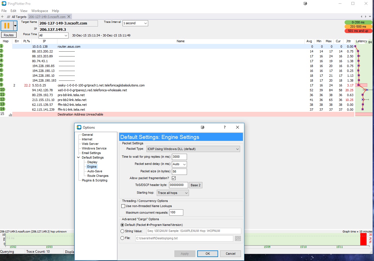

I've a question regarding failed Tcp - ping while on VPN (using PingPlotter).

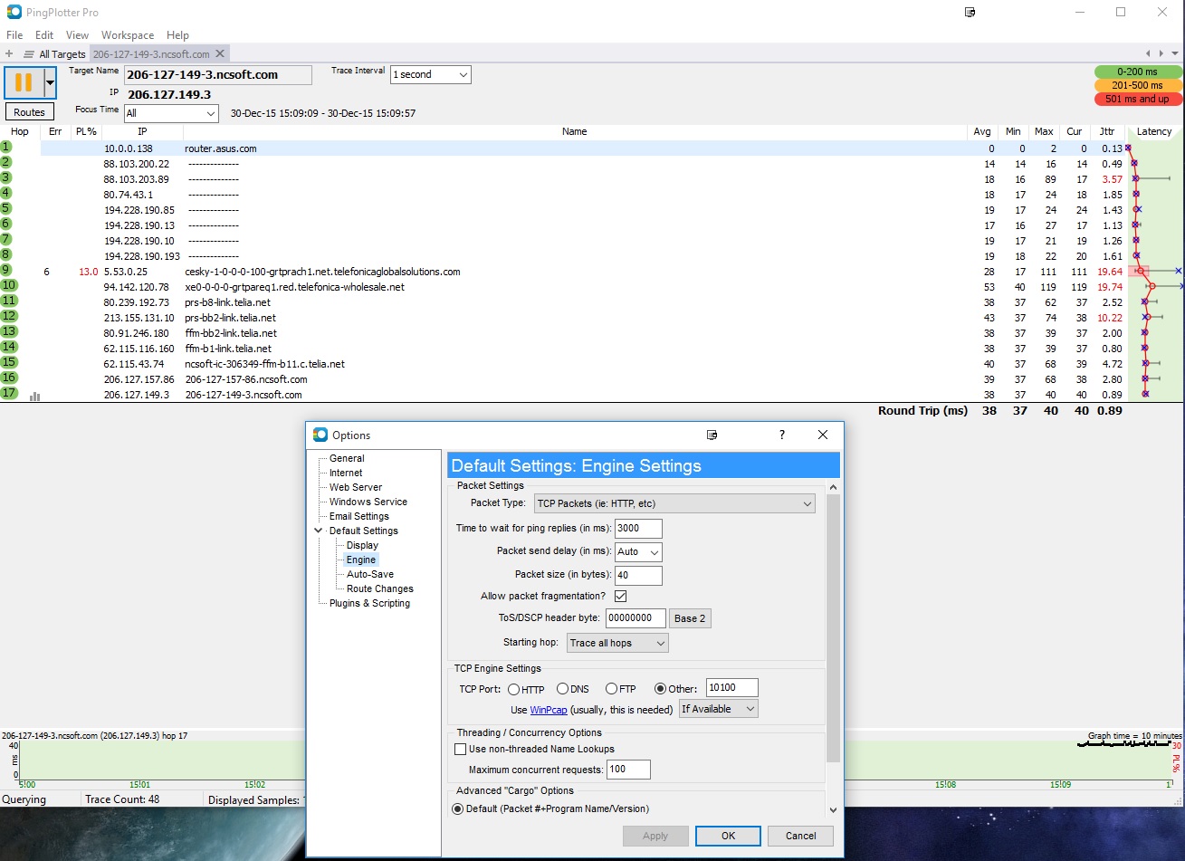

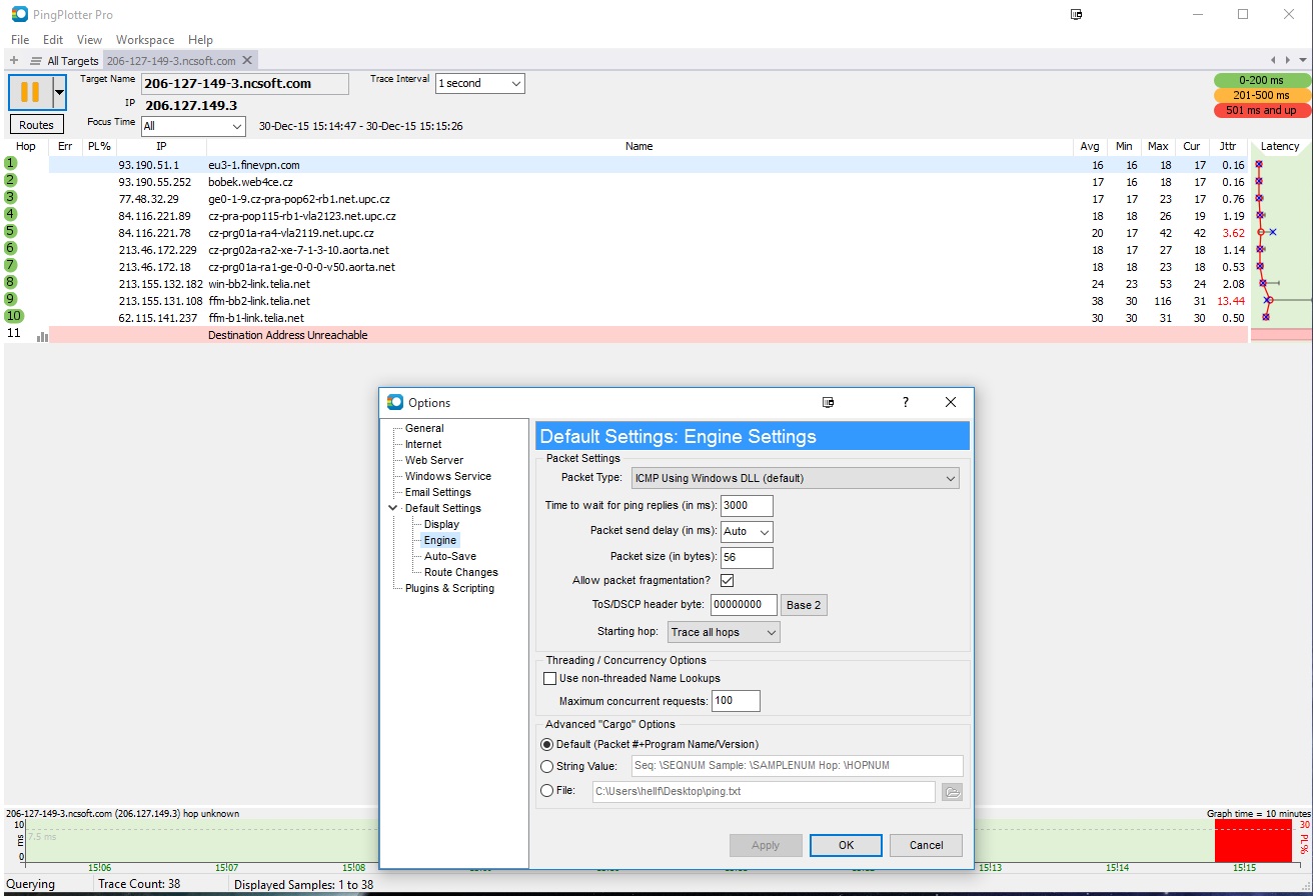

I am using PingPlotter to determin latency to gameserver in Frakfurt, Germany, due to ICMP block I am forced to use TCP-Ping on port 10100 (game client). I can ping using both ICMP without and with VPN with same results i.e. it tries to reach destination, but fails, because of ICMP block.

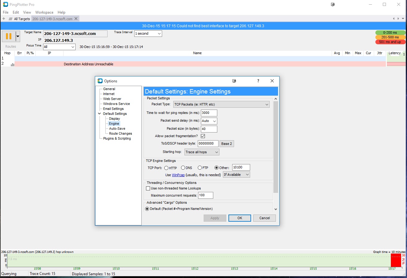

With TCP it's another story, I can successfully ping it without VPN, but with VPN I fail to even begin the trace.

Attaching files with ICMP/TCP with and without VPN (with options displayed)
Help please.
ICMP without VPN.jpg (324 downloads)
ICMP with VPN.jpg (691 downloads)
TCP port 10100 without VPN.jpg (735 downloads)
TCP port 10100 with VPN.jpg (670 downloads)

TCP requires WinPcap to work, and typically VPN's don't like to play nicely with WinPcap. You can read more about that in this article (specifically question 5):
https://www.winpcap.org/misc/faq.htm#Q-5
You can ping using TCP on a VPN, but traceroute is a different story, because without WinPcap, PingPlotter cannot separate the hops.
You may want to try using UDP to see if that gets a response.

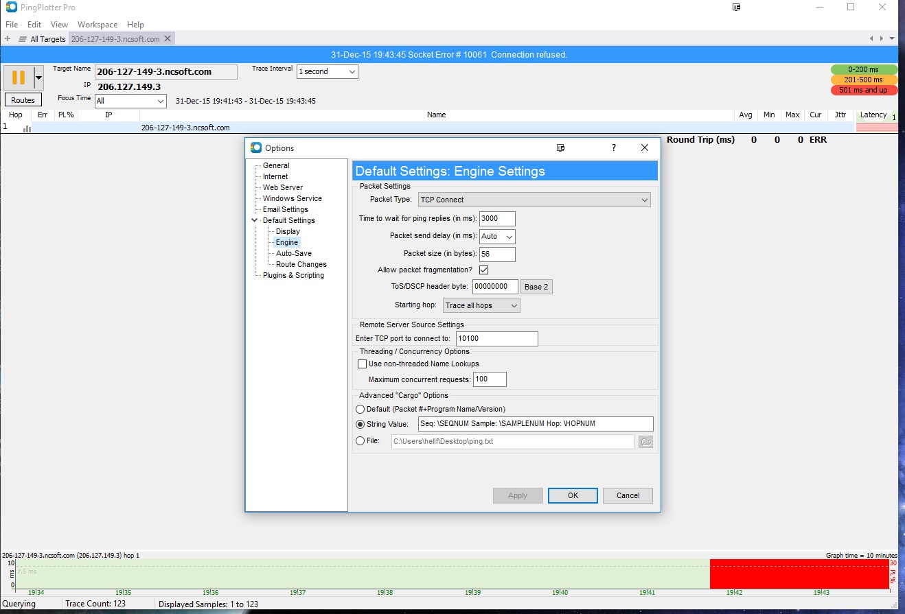

Seems like the connection is refused when using this TCP connect plugin. This is without VPN btw. I assume it won't work with VPN if it doesn't work without it.
I am kind of confused, since the normal trace works without VPN and this one doesn't, unless I have failed at setting it up, but it's the same IP and same port I've used before.

It seems like the target you are trying to reach is refusing a TCP Connection (handshake). While it may be responsive to a TCP ping, the TCP Connect script actually initiates a conversation with the target (which is what is being refused). You may want to attempt to trace to a target that you know is responsive to TCP conversations (i.e. PingPlotter.com using port 80) to ensure the script is working correctly.
Unfortunately, at this time, we don't have any other options available for you. I am going to submit this to our team to attempt to resolve for a future point release.

*edit Forgot to tell, that the script indeed works can ping google.com on P80.
