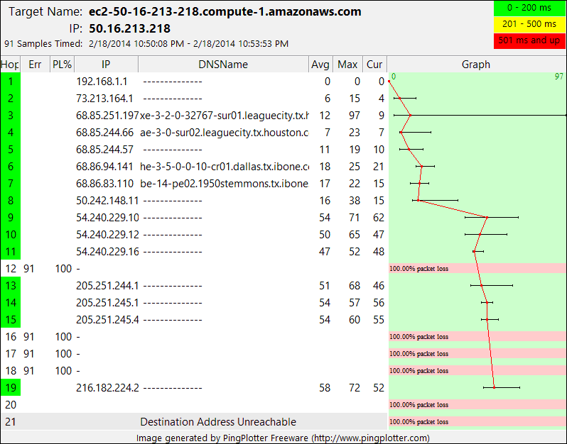

A couple of year ago when I first subscribed to Netflix I got excellent streaming. But for about a year now performance is erratic. Sometimes it takes a while for a movie to start, then it occasionally stops to catch up. Netflix says something like "the speed on your end is inconsistent, so it's your problem."
My Comcast speed is pretty consistently 55-56 Mbps. I'm in Houston and I use a server in Dallas for speed testing. I don't know exactly what the correct Netflix server address is but I'll show the results from a couple:
I don't understand much about this area but it looks like these plots indicate problems. Any help will be appreciated.

Hey Jim,
Based on the information you've provided here - I don't necessarily see any issues. The "Destination Address Unreachable" message you're getting is normal for both Amazon and Netflix addresses (unless you use TCP packet types, which isn't possible with the Freeware version). We have an article that goes over this, which you can find here:
http://www.nessoft.com/kb/8
The packet loss you're seeing in the intermediate hops isn't anything to be concerned about either - it just means those routers may be set to down-prioritize (or even block) ICMP echo requests. You can see a bit more info on this topic here:
http://www.nessoft.com/kb/24
A big advantage of PingPlotter Standard (or Pro) vs Freeware is the ability to capture data over time (allowing you to compare good and bad periods). From what we can see, your screenshot looks to be from a good period - and we'd need to see a bad period in order to come up with a theory beyond "Everything looks to be fine."
Gathering data over time (like, for instance, when you're watching a movie), will allow you to capture both the good and bad periods. and then you can go back and zoom in on the appropriate period to review what happened (instead of having to jump up to look at PingPlotter each time your movie starts buffering). For the absolute best troubleshooting results here, you really need PingPlotter Standard. The Freeware version is like having one good hand, while PingPlotter Standard is like having two good hands.
Additionally, Amazon Web Services (AWS) is pretty reliable. Most chronic reoccurring problems (more than 90%) happen closer to home - like in hop 1, 2, or 3 in your case. If you do decide to keep tracing with the Freeware version - I'd recommend watching for problems there. You can also increase your "Samples to include" to look back and see if you can find any packet loss or latency problems at a hop closer to home. If you can identify something like this, then you can focus your attention on that problem.
Hopefully this helps out a bit - please let us know if you have any questions!

I know the name for one of those destination is amazon but if you put the IP in a browser you will see it's really Netflix.
