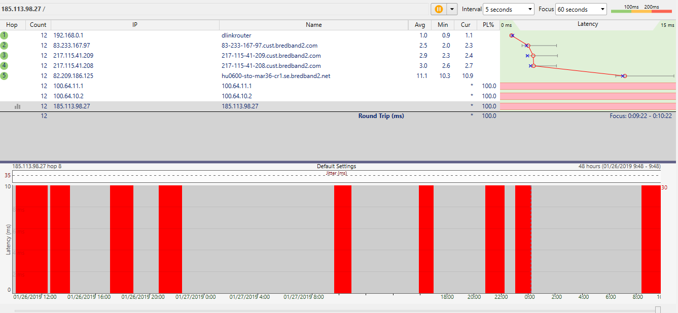

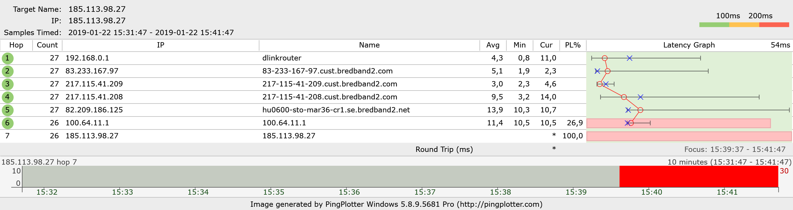

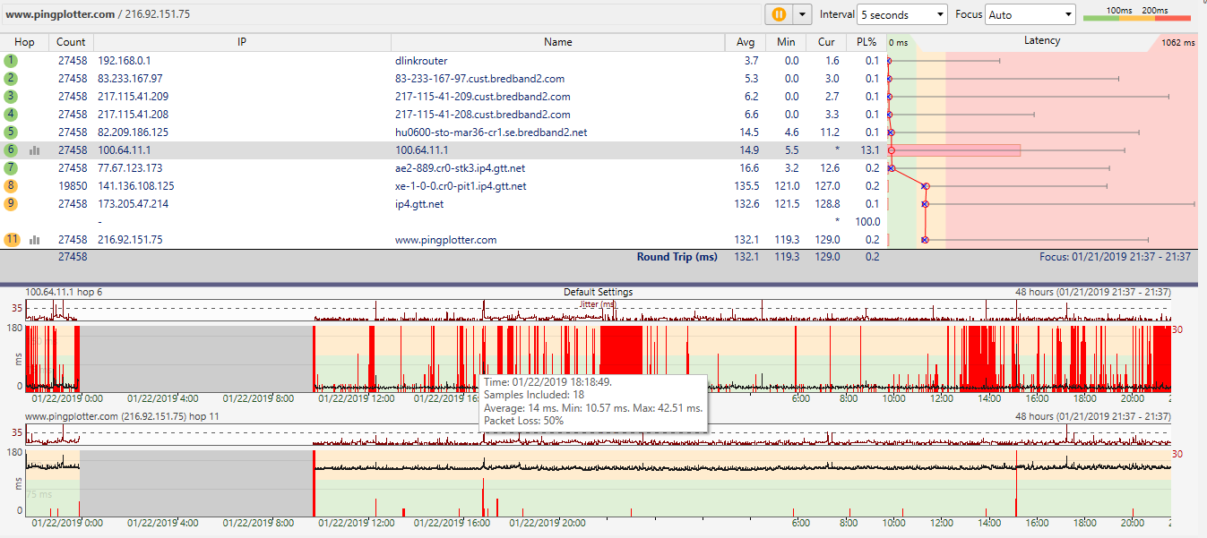

My first worry was the fiber connection. I think Pingplotter confirms this is OK ( going from my router to the www.pingplotter,com. - if someone can comment.
I have read up on NAT and Public and private IPīs so I think this is clear but on the plot there is an IP 100.64.11.1 - I gather this is something ficticious – something called ”shared adress space ” .Here there is always 100% latency.

The plot is really different.
Looking at network meny on the IPTV box it says public IP 185.113.98.27

Give that a try. I bet things will level out - and the reason I say this is, it looks like you have a bit of packet loss starting at hop 1 in your trace to PingPlotter.com, and it looks like it's carrying through. If it's starting at hop 1, we usually boil it down to some form of wireless interference or bottleneck at the router - and plugging right in can eliminate some of the variables that wireless introduces.
My theory is this: I think that you may be running into some wireless interference, or maybe a poorly performing router - and you can have all the fiber you want (still jealous by the way), but your link is only as good as your slowest device in the route. It looks, just from the screenshot, that things are getting choked either on the way to the router, or right at the router. Does that kind of make sense?

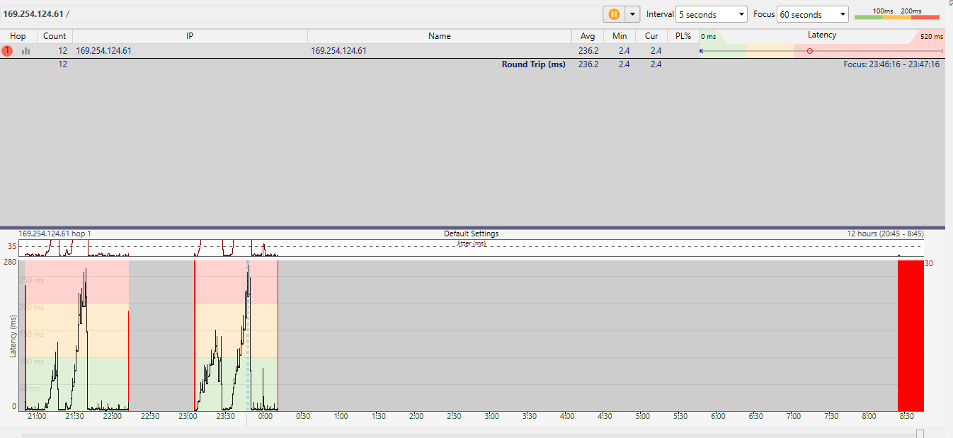

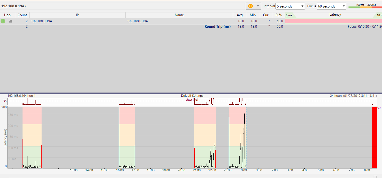

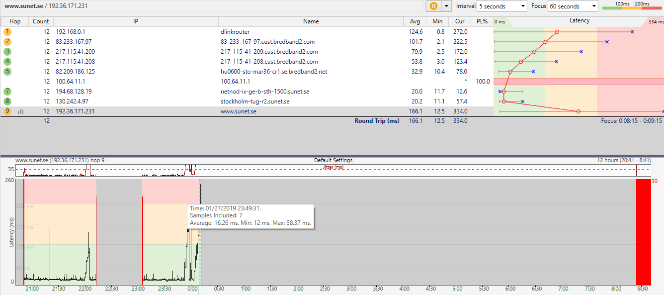

A large bit of luck this morning - the intermittent internet drop out occured at 00:10 this morning. So I quickly Went to PP to see what was logged during the night. I got a lot of good plots - all seeming to say the same thing - something happened at the router. But I still am not 100% sure what is happening - chicken or egg, and I have not yet had time to connect everything to LAN. Was it the fiber or the router.
The other strange thing was that I was able to switch on the TV from around 08:15 and it didnīt drop until 09:14 - but Everything else on the router (wi-fi) was dead.Kind of saying something on the wi-fi is causing peaks. I restarted the router at 09:15 and Everything is back to normal.The intermittant thing is a hassle I donīt know when it will occur again. I will try to split the fiber signal to Three routes 1. to the IPTV 2. to the router 3 to pingplotter This should allow me to see what happens.
I enclose the pics of the Point of failure.
Brian
public ip fail1.png (122 downloads)
internet sunet fail1.png (103 downloads)
Homeplug iptv fail1.png (112 downloads)
Homeplug fail1.png (116 downloads)
