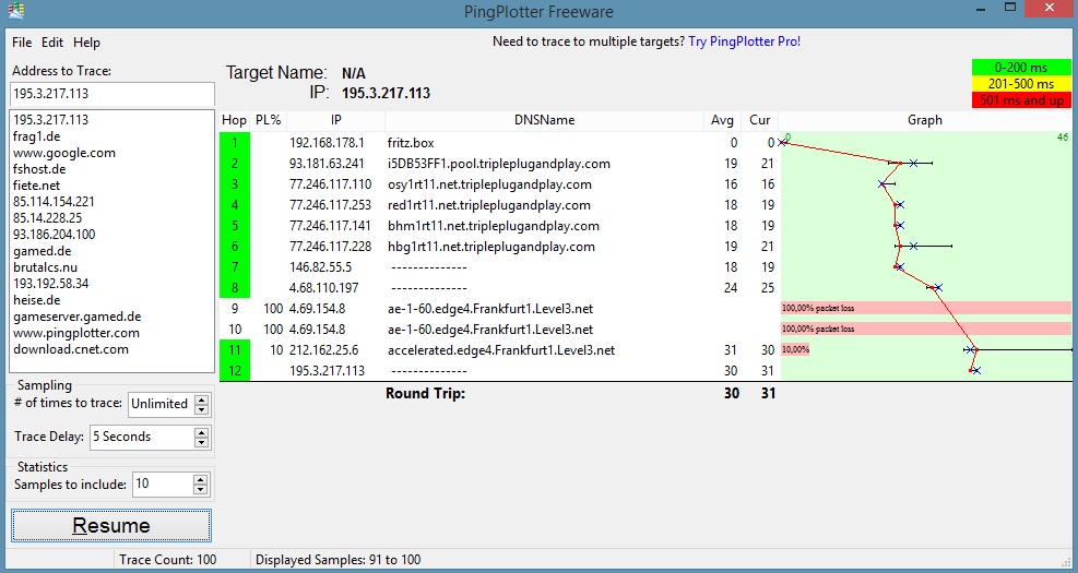

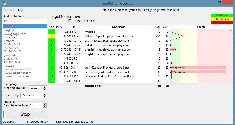

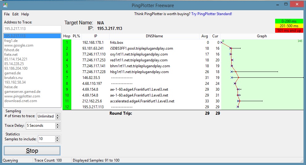

Hey guys,
first off thanks for providing support even for free users!
So I have already heard that pretty much only the last hop is important which is, according to pingplotter, almost never subject of packetloss for me. But since I've been experiencing some bad performance while playing online shooters I just wanted to make sure I'm not missing something here.
I've attached 4 screenshots which show different amounts of loss on intermediate hops. They have been taken within ~20 minutes just to give you an idea of how much fluctuation is going on. In-game net graphs of different games also show some amounts of loss.
All these performance issues only occur between 6 to 11 pm and they match pingplotters intermediate hop loss displays. Late at night there is never even the smallest amount of loss on intermediate hops and gaming becomes way more enjoyable.
Hope there is something I can do (or tell my ISP to do)

You're dead on here - the most important hop is your final destination. Often times when you see packet loss at an intermediate hop, it's because the device at that location doesn't prioritize timed out ICMP request very high (or doesn't respond to them at all). As long as the packet loss at these hops doesn't carry through to your final target - then you don't need to worry about factoring it into your troubleshooting efforts. We cover this topic in a bit more detail here:
http://www.pingman.com/kb/5
That being said - the four screenshots you've attached here don't specifically point to any sort of a problem (around 30ms round trip latency with no packet loss to a final destination is *usually* a pretty good result). That isn't to say that you aren't experiencing any issues, though. At this point - the best course of action is likely to continue your monitoring. Ideally, you want to keep PingPlotter running continuously (even in the background while you're playing your game).
