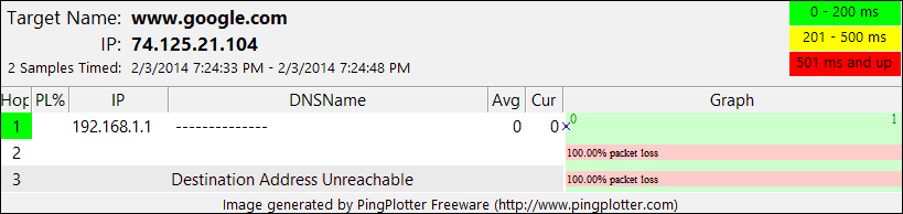

I downloaded PingPlotter and am trying to use it, but it won't plot. Here is all it does no matter what destination/target/domain I enter:

I took a quick look back at your previous forum post - and it looks like things were running fine back then. Have you by chance made any changes to, or replaced your router since you've last run PingPlotter? Usually, when we see the "Destination Unreachable" message after the first hop, the likely culprit is the router. You may want to check your configuration there to see if it's currently set to block ICMP echo requests.
Alternatively, you might also check to see if there is a more recent firmware version available for your router (oftentimes, issues like this are discovered by the manufacturer and fixed).
If this leaves you with any questions, or if you need some assistance - shoot us the info on your router (brand and model number), and we'll be happy to look back through our support tickets to see if we have information about this router that might help solve the problem.

That was it. I had changed routers about three days before this happened. I hadn't used pingplotter in quite a while so I had downloaded and installed the current version and thought that must be the problem.
