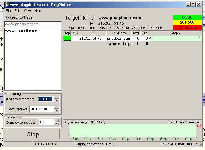

PP works fine with my RoadRunnerconnection, which assigns a dynamic IP address. However, on Verizon FIOS (fibre optic) I get a zero round trip time connected directly to their Router, which has a static address. No Hops are shown.
The display shows the IP address of the pinged site, but 0,0 for round trip.
I have no problem accessing the internet, just cannot get valid traceroutes with PingPlotter.
Suggestions?

This definitely sounds like a problem with the router. Where (which hop) does the final destination show up with 0ms latency?
A 0 round trip time to the first hop isn't abnormal, but not showing any intermediate hops and showing 0 ms to the final destination sounds like a TTL Expired bug in the router. I would check for a bios update for the router. I'd also try the command-line TRACERT command to see if it behaves any different. There might be a problem with multiple outstanding requests in the router.
If you post a screenshot of what you're seeing (you can attach a .png image to a post), then we may be able to offer additional suggestions (based on the hop the final destination is responding).

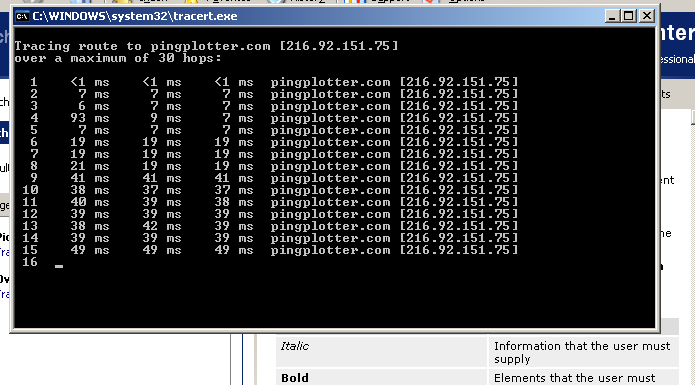

Here is pingplotter and tracert Note the subtle difference...

I was unaware of this, but it looks like you do have to be logged in to add an attachment. For editing, you definitely need to be logged in. Just create an account (which is pretty much instant), and that should get things working for you.

Done.
See message 3 re: tracert and pingploter graph.

And..
#1698 - 07/09/06 03:52 PM Re: PingPlotter and Verizon FIOS [Re: Enginer]
Yup - that's a bug in your router bios (whatever is at hop 1).
It looks like it's changing the source IP address for all of the returning ICMP TTL expired packets to be the target's IP address. That's one I've not seen before.
I would get ahold of Verizon and see what they have to say about this. You *may* have better luck reporting the problem with TRACERT instead of PingPlotter, since TRACERT is more pervasive (since it's installed on all machines).
Actually, the *first* thing I'd do is look to see if there's a bios update for the router (the one physically at your location), since that's probably the culprit.
Based on this behavior, I don't think there's any setting you can change in PingPlotter to change this behavior. You might try TCP or UDP packet types, just to verify, but since it looks like it's a problem with the NAT handling on the returning ICMP TTL Expired packets (and that is the same packet types UDP and TCP use), you'll probably see the same results with those types as well.
Please post back here if you make any progress or breakthroughs on this problem (or if there's anything else we can do to help).
