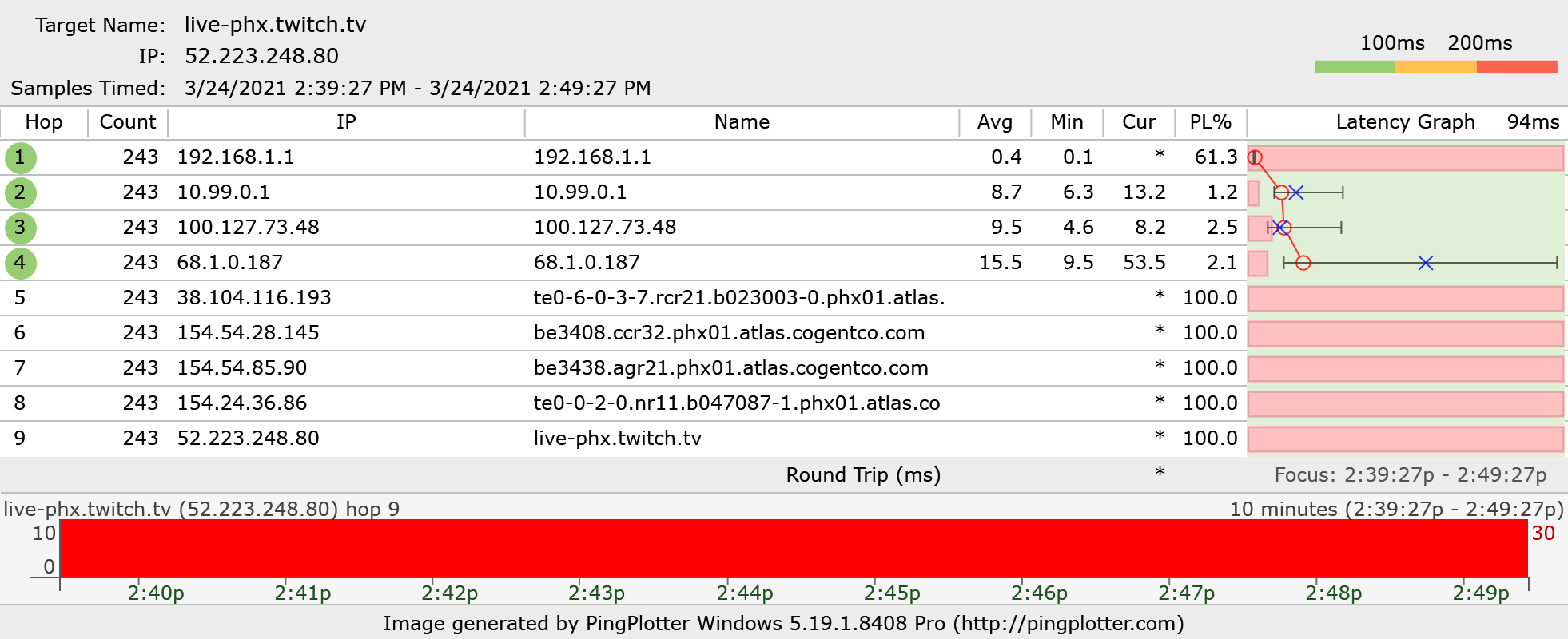

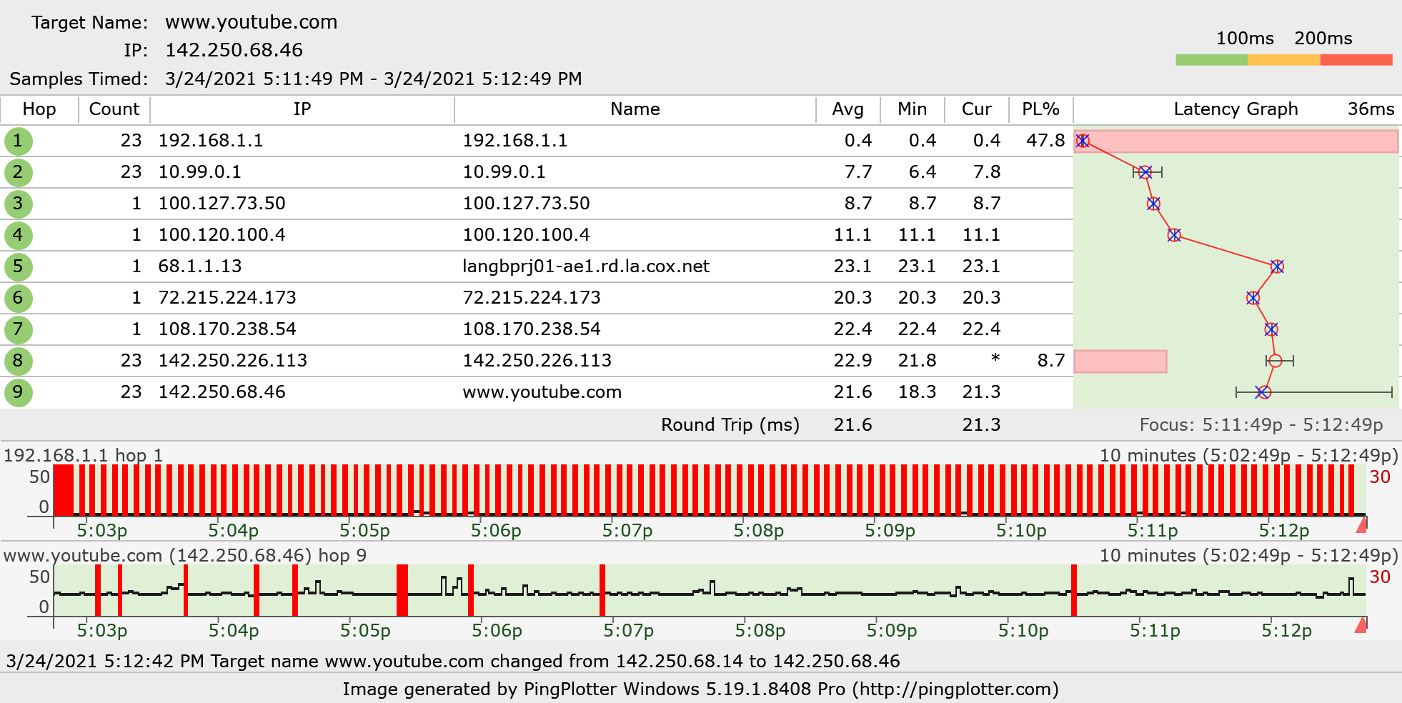

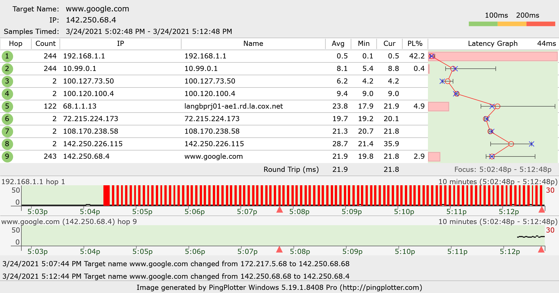

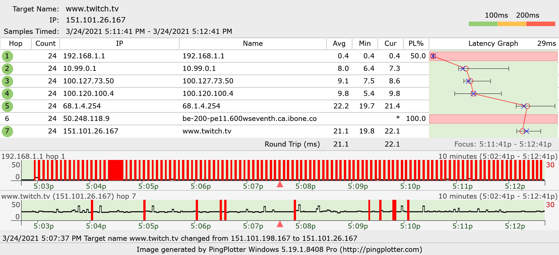

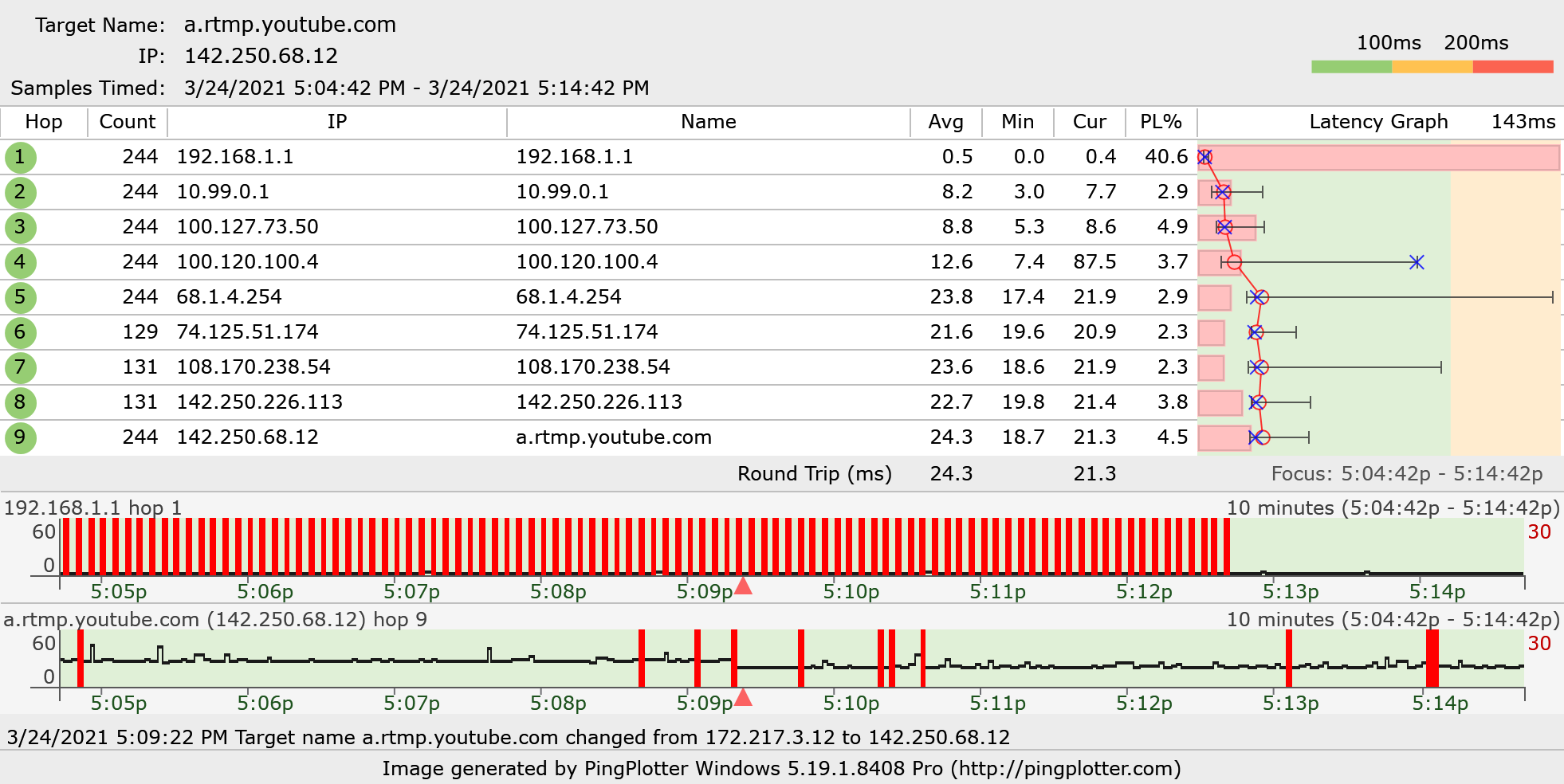

I've been using pingplotter lately to solve my bandwidth issues. The thing is, whenever I stream, my bandwidth gets unstable ranging from mid 1k to 0. To fix it, I got a new router and it seemed to have fixed it. Only for the issue to return a day after. So I use pingplotter to see if I can find what's causing it. I tested on a few sites I regularly visit as well as googles dns and the servers I stream to. Throughout my tests, I noticed that I'm getting a lot of packet loss on my router in hop 1 despite it being brand new and streaming just fine the day before as well as ms increasing after hop 4. In addition, I can surf the web and watch other videos and streams no problem. It's just streaming to either twitch or youtube thats been having issues. Can anyone help me out with deciphering these tests and what all this possibly means?

In regards to your PingPlotter screenshots you shared, the packet loss you have observed at the first hop is a bit of a red herring. Some routers just don't prioritize timed out ICMP requests very high (ICMP requests where the TTL equals 0 after reaching them) and this is the case with your router.
If you run a trace directly to your router (192.168.1.1) it should prioritize these packets better and show little to no packet loss. You can read more about this in the following article:
One Poorly Responding Router
Another very important takeaway from the article above is that the most important hop in your trace is the final hop, if the results at the destination look good (acceptable latency and minimal/no packet loss) then everything that comes before it can be ignored.
In this case, due to the nature of screenshots, it is difficult to say where the packet loss that does carry through to the final hop originates. If you look through the following articles about interpretation you can get a better idea of where the issue could be starting while looking at your results.
