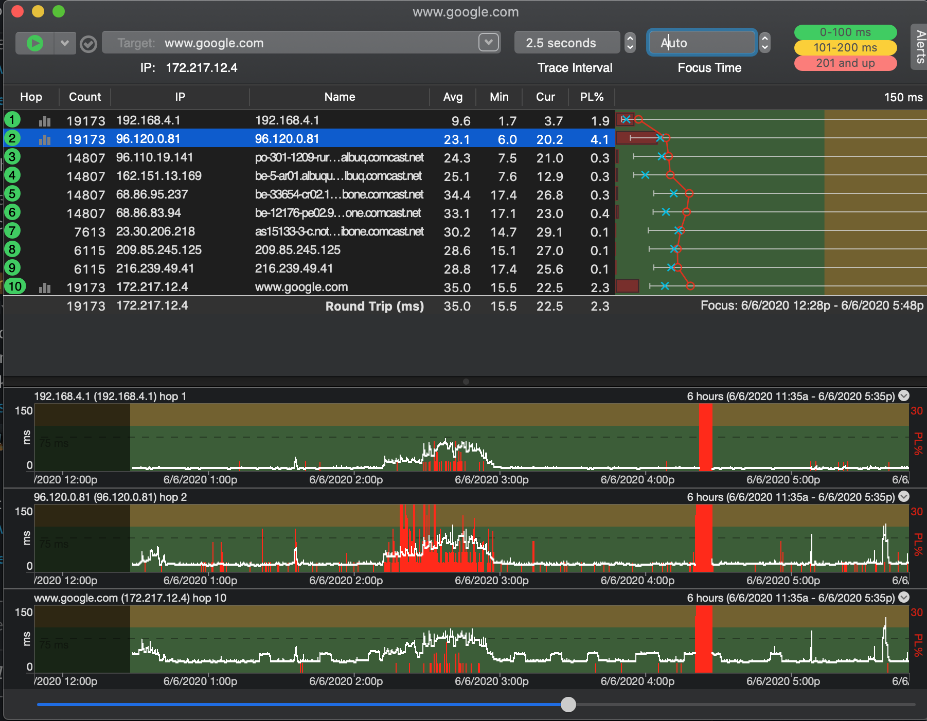

For the past few months, I have been experiencing major packet loss on all hops after the second. After getting a new modem from my ISP, the issue has decreased in severity, but the problem arises at least once a day. This leads to large ping spikes when in games, as well as voice and video dropped from programs like Zoom and Discord. I have also upgraded my home recently with gigabit, yet when downloading large files, like a game, there is large amounts of ping spikes and packets dropped on all hops.

I imported your data into my instance of PingPlotter to take a closer look, and what I found was pretty interesting. It appears that there was about an hour-long "chunk" of spiked latency and packet loss starting at hop #1, but a handful of instances throughout the session indicated periods of latency spikes starting at hop #2.
My first thought here is that the hour-long chunk could be related to something like a game download, which may have been over-saturating WiFi (but that's just a guess). Regarding the other instances of spiked latency, those seem to be happening at hop#2, which is the first hop in your ISP's network.
Could you please tell me a little more about your network setup, and the problems you're experiencing with certain services? Does this issue happen on wired and wireless? At certain times of the day?

Screen Shot 2020-06-08 at 3.09.12 PM.png (263 downloads)

The main problems I have been having are over voice communications like Zoom and Discord. Somewhat randomly it seems, with no downloads going or nothing, the voice and video will randomly stop working, or people I am speaking with will say I am starting to sound distorted. This happens on both wired and wireless.
Currently, I am running an Eero wireless system, with 5 eero pro beacons distributed throughout a 5000 sqft home. The pingplotter data shown is from a desktop that is connected to an eero node, so not directly to the node that is connected to the modem.
Also with the game downloads, is it normal to be experiencing that much latency even though I have upgraded to gigabit download speeds? The latency is the same from all computers, even ones directly connected to the gateway eero node.
