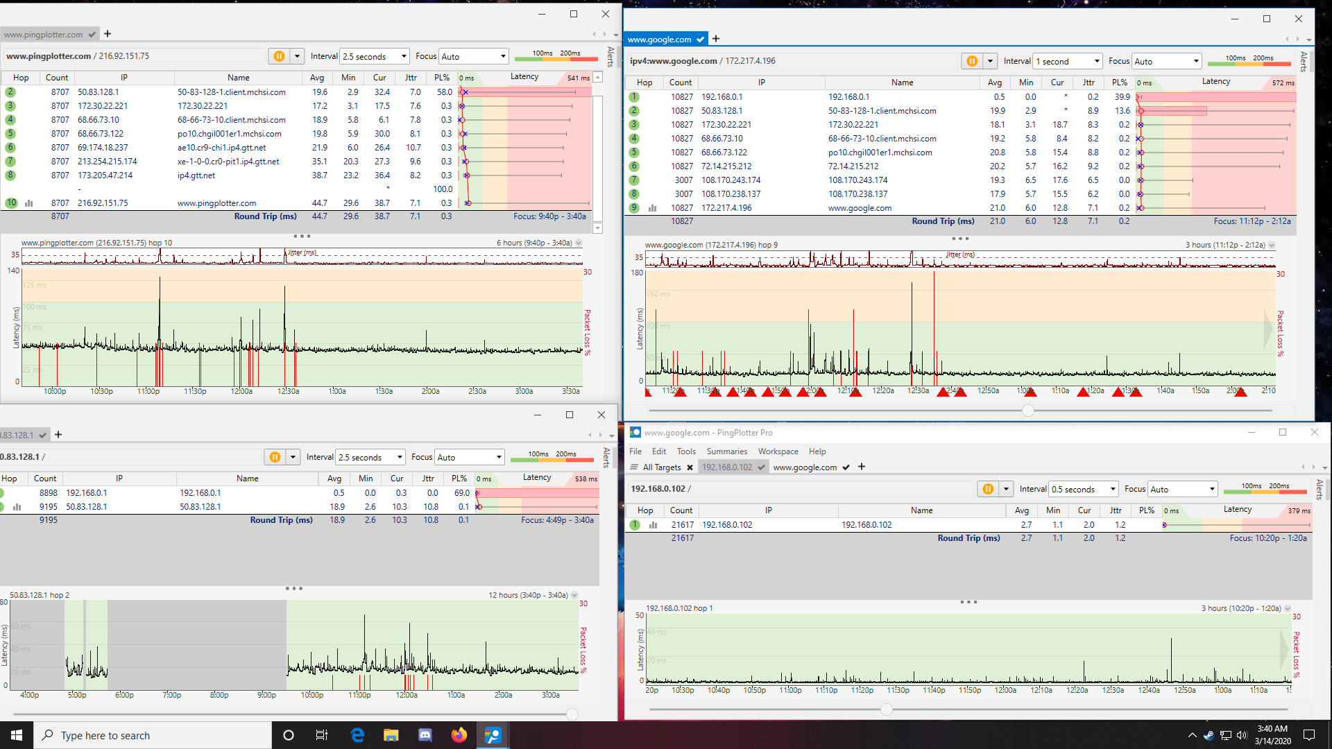

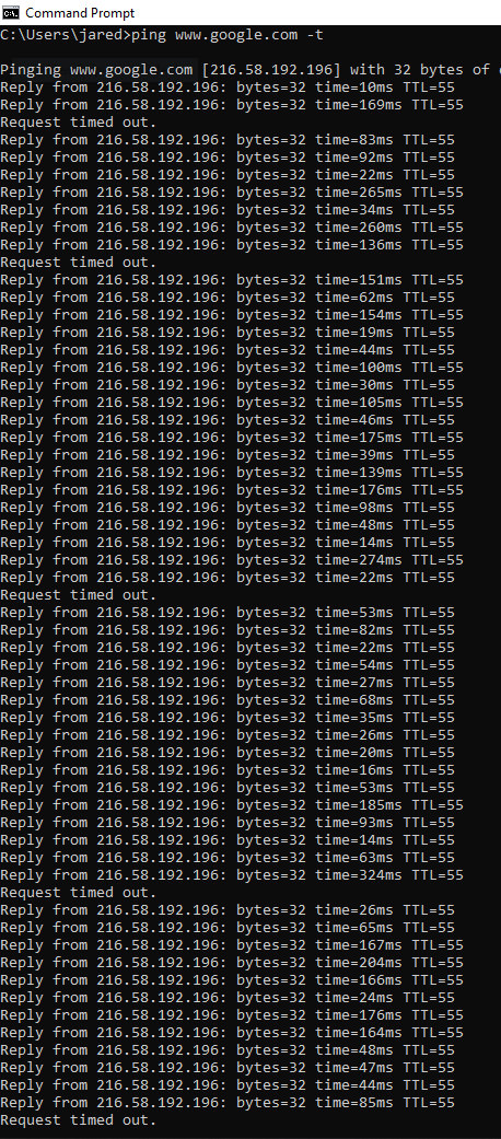

Seems to be a problem with isp nodes. so far they just want to keep looking at my equipment and say that everything looks good.
any ideas?
uploaded 4 pictures that all shows the ongoing issue.
loss starting at hop 2.PNG (325 downloads)
delay in final hop originates in hop 2.PNG (253 downloads)

I would agree with you - from just the screenshots I saw, it does look like there's an issue at hop 2. This hop normally is the ISP's demarc - so the issue could be with your connection to their demarc, or with the equipment at that hop.
My suggestion would be to get in touch with the ISP and let them know what you found. Typically, you can send them over PingPlotter results and they should be able to look at that and start their investigation. However, if you find yourself needing to make a case to your ISP, you can use the following resource to guide you in making an efficient and effective case:

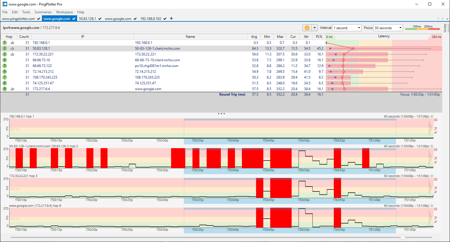

From your first couple of images, I would tentatively say that it's pretty clear that the issue starts at hop #2 but then I looked at the third image and it is a bit masked by the 39% packet loss on hop #1. I would say that rather than just sending your ISP screenshots we'd suggest sending them PP2 files so that they can look at the data over a 24-48 hr period and see the trends. Here is an article about Building a solid case to present to your ISP.

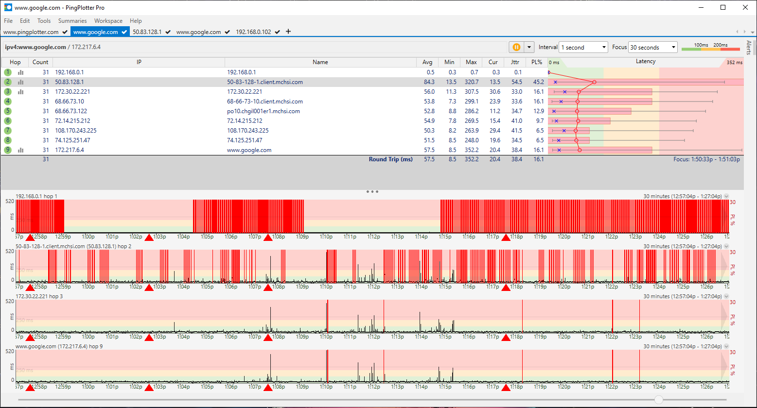

After taking a look at the pp2 files you shared with us (thanks for those by the way!) I see that you certainly have intermittent low-level packet loss with some larger spikes as well as some significant latency spikes.
Since your router is showing constant packet loss it's hard to know where the packet loss and latency starts. I'm guessing that your router is simply set up to de-prioritize ICMP packets where TTL = 0 and prioritize other traffic instead.
There are two ways to see what's going on with your router. The first way would be to trace to your router directly because when you do that the ICMP packets that PingPlotter sends won't have a TTL = 0 and it should give you accurate packet loss and latency data. The second would be to change the settings on your router, at least temporarily, to not de-prioritize ICMP traffic where the TTL = 0. To do this you'd have to google your router make and model and ICMP to find instructions of how to go into the settings and change it. Here is a link to instructions on how to change it for your TP-Link router.
The screenshot above illustrates why you need a clear view of your router. It shows a spike to 320 ms of latency at the final hop which appears to start at hop #2 but you will also notice that hop #1 isn't showing any latency results at that moment and in the timeline graph, it's only showing packet loss.
If you can rule out your router as an issue for the latency or packet loss then it should clearly show that it starts on hop #2 or #3 which both seem to belong to your ISP. The switching back and forth between IP addresses from the 50 to the 173 IP addresses is likely just because they are load balancing their traffic in some way. It could be an issue but only they will ever know as you have no visibility as to what is going on.
Do a trace to your router as well as a trace to google.com and open both graphs and see where the packet loss starts and that should likely give you what you need to take this to your ISP with clear evidence as to where the issue lies.

The IP of 173.18.240.1 for hop #2 in your route does indeed have strong evidence to suggest an issue. It appears that the device at this point is contributing to some latency spikes and most (if not all) of the packet loss you're frequently experiencing.
As Poe and Hayla suggested earlier, the best thing you can do is make a great case to your ISP - showing the evidence, correlation, and impact the problem has. In addition, I'd also recommend pushing to speak to a supervisor for most of the conversations. If you continue to be a "squeaky wheel" to your ISP, chances are they'll invest more time and effort into fixing your problem.
