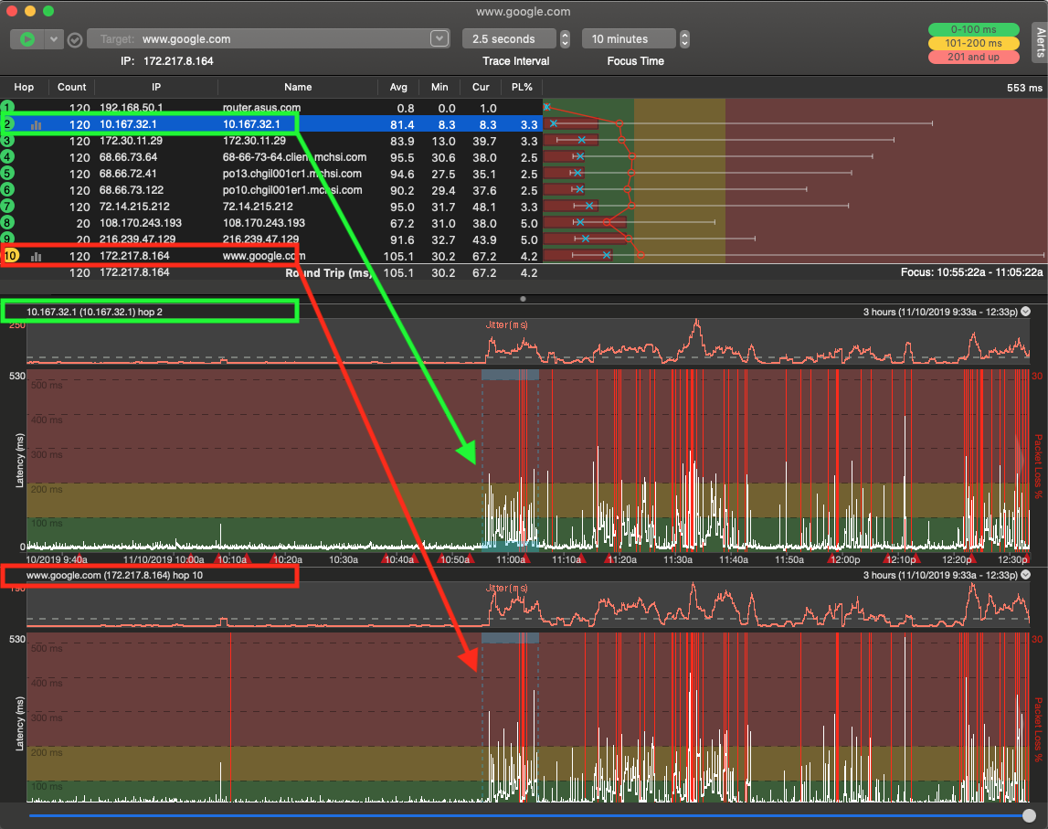

I have tried everything to fix my problems. My internet is great 90% if the time, but that other 10% is driving me insane. I only see it in gaming, creating near unplayable conditions due to lag/rubberbanding.
Have tried 2 different modems, and 2 different routers, isp keeps telling me it has to be my equipment because they see nothing on their end and everything checks out fine when they come to my house and hook up their little diagnostic meter. I have had a new drop to my house, and ran a new cable from where the drop comes in to my modem. Replaced all other cables as well. This has gotten to be so damn frustrating...

I pulled in the data from your share page into my instance of PingPlotter, and it looks like the primary troublemaker is hop #2 (10.167.32.1). There does seem to be intermittent packet loss starting in the middle of the route (which is exacerbating the issue), but these are few and far between.
I attached an image of my findings, which I annotated for your convenience. If you'll notice, the pattern of latency and packet loss carries through from hop#2 all the way to the destination (google.com).
Since this issue seems to present itself only during gameplay, there's a slight possibility the issue could be related to bandwidth saturation. You can use some online tools and test your bandwidth, then cross-reference those values to what your ISP is currently offering you.
From what you've described, the device at hop #2 could be your modem. If not though, it's likely a device owned by your ISP - in which case, showing them this data should give them an incentive to fix it.

Thanks for the response. The issue is only seen while gaming, it happens all the time at random times not matter what I'm doing, but since gaming is so dependent, especially in a FPS game, upon a stable connection, that is where I really see it. I have several nest cams running on my network also and they never skip a beat. Ive been dealing with someone on dsl reports that works for mediacom and he is really trying to get to the bottom of everything. Hop 2 is most definitely my modem, but having tried different modems, we have ruled that out as the cause. He ran a voice session on my line the last few days, and while he is not seeing any signal issues, he was detecting the ping/latency issues but is unsure of the cause. He has escalated it further and techs are coming out tomorrow. So at least I finally have someone saying its not my equipment that is causing the problems which is a step in the right direction I guess.
As for the steps listed, I have traced everything on my net work and it all comes back fine. The only place I start getting the packet loss is when I go past Hop 2, my modem. I have my PS4 hardwired to my modem independent of my router, everything else goes through my router, so that further shows it is happening at the modem, only its not actually the modem that is the problem considering we have tried 2 other modems from mediacom as well...
