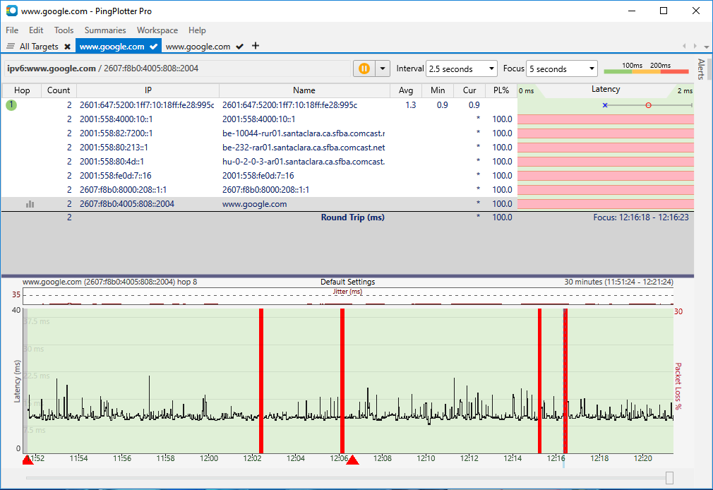

Hi there!
So I've been trying to figure out what's been going on with our internet the past couple week and I've been having no luck. Any fixes my ISP have done hasn't improved anything. Wired or wireless connections all cut out at the same time and the disconnects happen at random intervals. According to pingplotter, it's always after the first hop and it's always 100% packet loss from then on and only for a few seconds. Any help or suggestions would be great!
Ping - 1-23-2019.PNG (517 downloads)

Hi Rainling,
It's a bit tough to speculate on what may be going on here with the limited amount of data we can see in the screenshot you provided. There's definitely some packet loss occurring at the final destination in your trace - and it *appears* that it's starting at hop #2, but we can't tell for certain without being able to see some additional information for the intermediate hops.

Thanks for reaching out! I've shared a ping test here: Ping Test
If there's anything you can glimpse from it, I'd be most grateful!
I've gone through your walkthrough and have been unable to determine if it's an outside or local problem. I definitely haven't stopped trying though!
