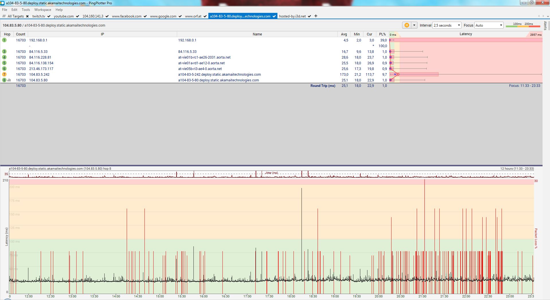

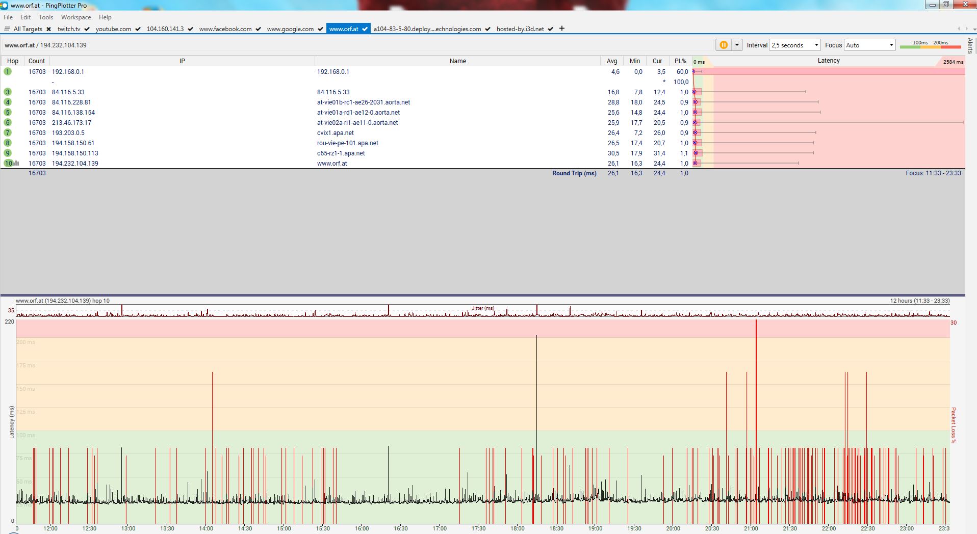

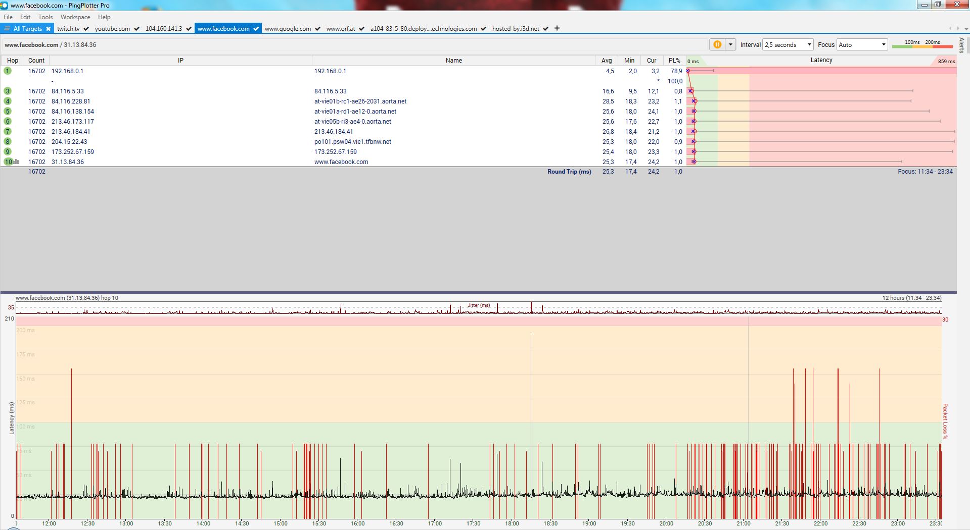

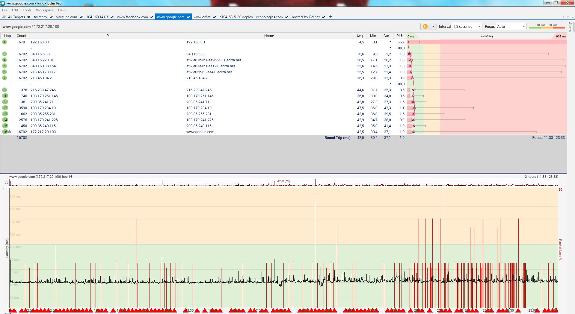

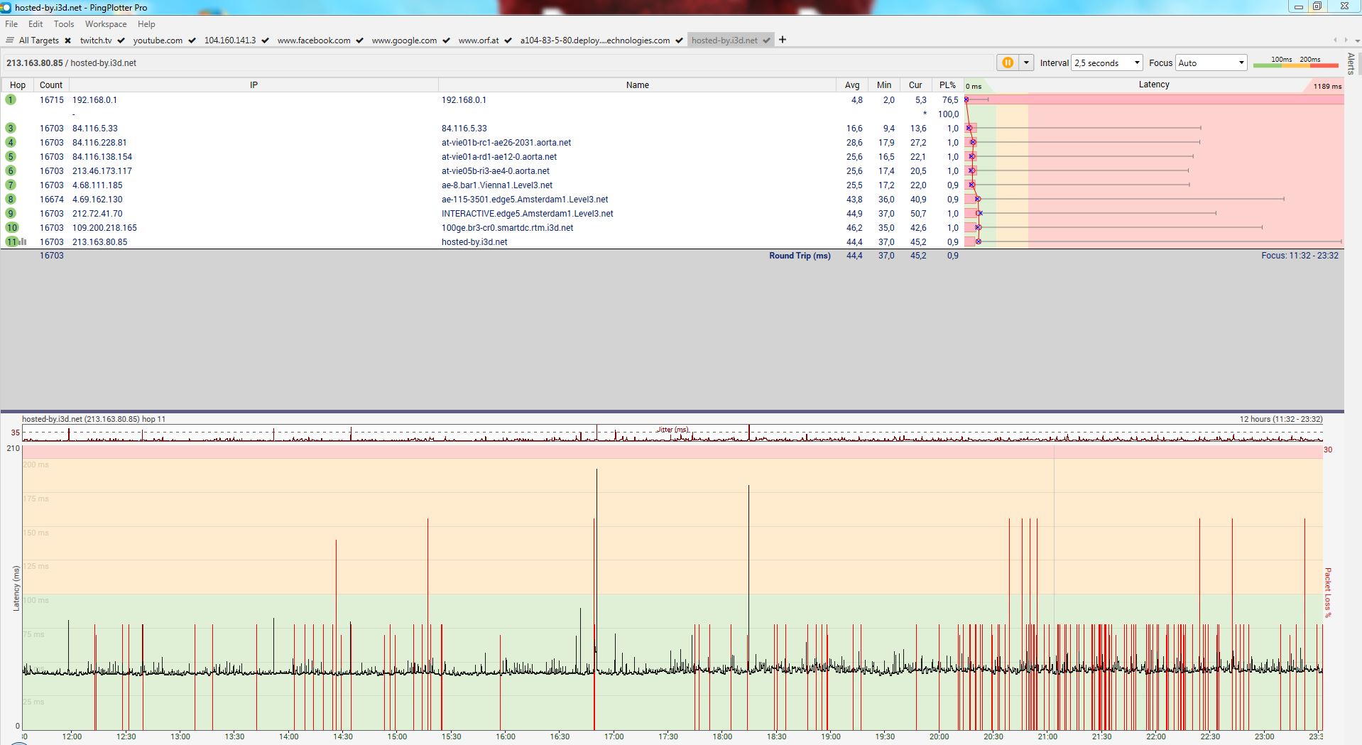

Dear all,
thank you for taking your time and going through this post. As you could tell from my caption, I am desperately looking for answers.
I have been experiencing packet loss for over half a year now and my ISP seems to be far away from resolving the issue.
I hope you can help me with interpreting the screenshots of my PingPlotter, because unfortunately I cannot fully understand the results (and obviously neither my ISP, eventough they recommended PingPlotter).
Referring to my screenshots:
- do I experience a packet loss of 0.9-1%?
- does every red bar indicate packet loss?
- in this case, could there be any other reasonable cause for rubberbanding (lag, pingspikes) in online games or puffering when watching videos?
- what could be the reason for this packet loss or what could i tell my ISP to check?
I have run PingPlotter on 2 PCs and 2 Laptops, via LAN or WIFI.
This issue occurs
- at every time (not related to capacity, e.g. at noon)
- on every device (smartphone, pc, laptop, tablet, console)
- WIFI and LAN
To my impression, the packet loss increases with higher internet usage (e.g. two PCs for online gaming -> Refer to 20:30 - 22:30 on my screenshots.)
Things that have already been done by my ISP:
- all standard checks like upstream, downstream, latency and so on. At least a dozen times, no sign of packet loss or any other issue according to them.
- sent 4 different technicians (they acknowledge the issues, but have no idea where they are coming from)
- replaced modem (5 times)
- replaced cable connection from my appartment to their junction/splitter
- checked their junctions, no issues visible
- connected my modem directly to their junction in my building (problem also occurs there, so it cannot be related to my appartment, right?)
I feel like they have done everything that comes to their minds, but ran out of ideas.
For those who are really interested in helping or sharing their thoughts I'll provide a more detailed description and history of the issue, but also try to keep it as short as possible:
I am from Austria, my ISP is UPC, which belongs to Liberty Global. The first 10 months of my contract were without any issues. Starting in May 2017, I experienced rubberbanding issues (lag) in several online games and an extraordinary amount of puffering with video streaming (e.g. facebook, youtube, netflix, amazon, twitch...) on a daily basis. I would say these symptoms occured approx. once every 5 minutes. The service hotline always runs their standard checks (upstream, downstream, latency) and tells me everything is fine. However, with the help of PingPlotter I was able to convince them of packet loss so they sent me a technician. Unfortunately this technician had no idea where the issue is rooted. I showed him the PingPlotter results and was even able to show him the symptoms (rubberbanding and puffering) live. He proceeded to check all cables in my appartment, then the connection to the junction in my building and even the connection to the junction in this district/region. He said he is sorry, but all checks were fine and there is nothing he could do. This time, I should send the PingPlotter screenshots to the second level support, who are supposed to be the experts and will take it from there. (Fun fact: one of them recommended to replace the cable to my PC even though I insisted that the issue is also occuring via WIFI). After looking at the screenshots the second level support said that all their tests were fine and they have no idea what could be causing the issue. However, they sent me another technician. The technician made the same tests as his collegue a few weeks ago, couldn't find the issue and forwarded me again to the second level support. Now, this keept going back and forth. In October, after the last technician was here, the issue was suddenly gone. The technician said he didn't do anything differently than his collegues and does not really know why it works now. However, since mid of December the issue has been reoccuring. Now, I am already close to resigning, not just from my contract, but also from faith in ISPs. Tomorrow the fifth technician will come over and most probably tell me to contact second level support.
I have found several threads on the internet which outline similiar or even the same symptoms, also with the same ISP. However, their is never a solution attached.
In case anybody is interested, I have exported the PingPlotter project and could upload it here.
I am very much looking forward to your suggestions.
Many thanks and best regards,
Dan
facebook 12h.JPG (290 downloads)
google 12h.JPG (455 downloads)
Rocket League Game Server 12h.JPG (350 downloads)
Steam Server 12h.JPG (306 downloads)
ORF 12h.JPG (369 downloads)

Currently, the data that I can see does point to some packet loss, but I don't have enough information to tell you from where it's originating. It looks like you've got about 1% packet loss consistently; to answer your question, the red bar does indicate packet loss. I can't quite say what the reason would be for your particular packet loss (there are literally thousands), but I definitely can confirm that it's there.
So, in order to find out what’s going on, you'll need to let these traces run for quite some time and investigate the results to be sure. Your goal here is going to be to correlate the issues you're having to PingPlotter patterns. You'll want to start a trace running to the service you're having troubles with (it seems like you're having troubles with most external services, so really any one will do), and leave that running while you're accessing the service. When you're experiencing poor service quality, make a note somewhere of what time it happened, and look back on your PingPlotter data to see if you can find a problem pattern that relates to when the undesired behavior first started.
