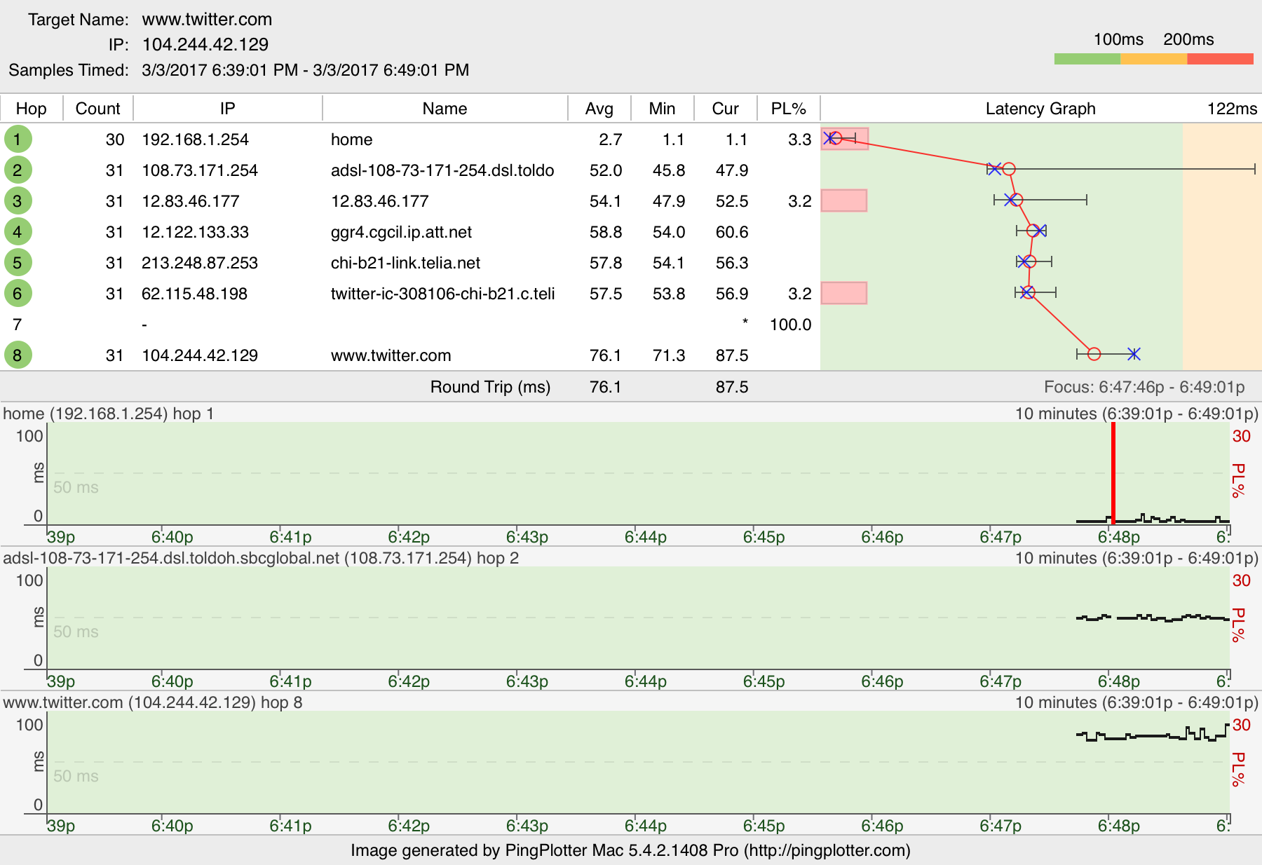

Internet pages seemed to take forever to load. I started looking up Internet speed tests to run, and I ran them several times a day, especially when we were experiencing a lot of problems. It would show speeds of close to 0.00 mbps for both download and upload, but especially for upload. I downloaded the free version of ping plotter to look at it. It showed a lot of latency and red lines at the second hop.
After 2 months of that, our ISP fixed some things on their end, and our Internet started working better. I checked ping plotter, and the second hop did not show the problems it had earlier.
Well, recently, within the last few weeks, things seem to be getting bad again. This time, though, the speed tests results are more normal to what we normally get. (1.00 Mbps download, and 0.32 Mbps upload). There is quite a bit of variation, though. I will run a speed test at one moment, then run the exact same one the next, and my numbers will be quite different.
The thing, though, is that we do get a lot of latency, especially at that second hop. We get latency as soon as we do something on the Internet -- anything on the Internet. I can type something into google, and as soon as I hit enter, my latency will spike at the second hop. When not doing something on the Internet, the latency at hop to is about 50ms. As soon as I do something, it spikes somewhere from 200-2000 ms, usually around 500-1000 ms. I don't know that this is normal. I doubt that it is, but please let me know for sure.

Hop 2 is 108.73.171.254
There is a lot of red that shows in the charts due to the high latency.

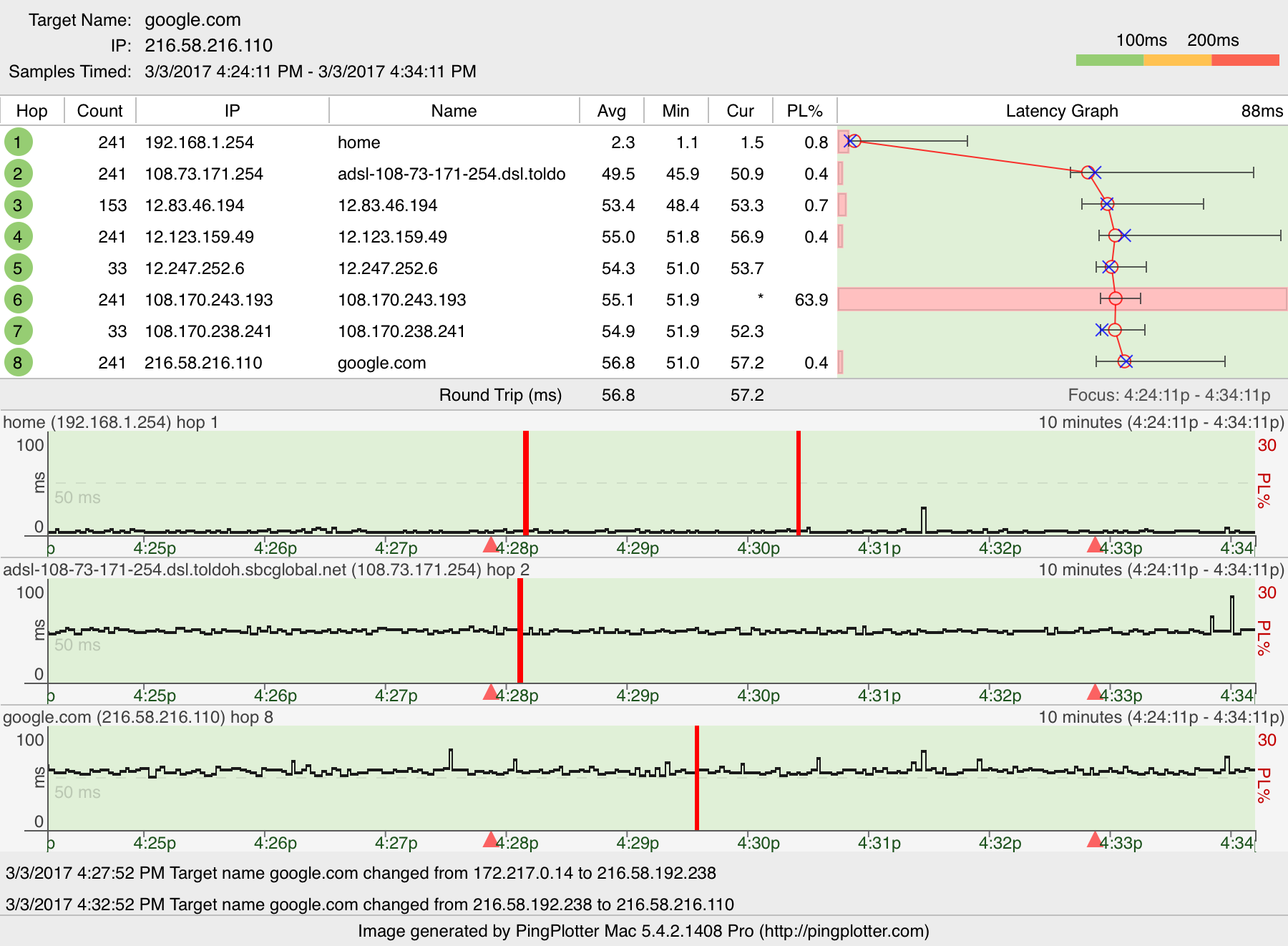

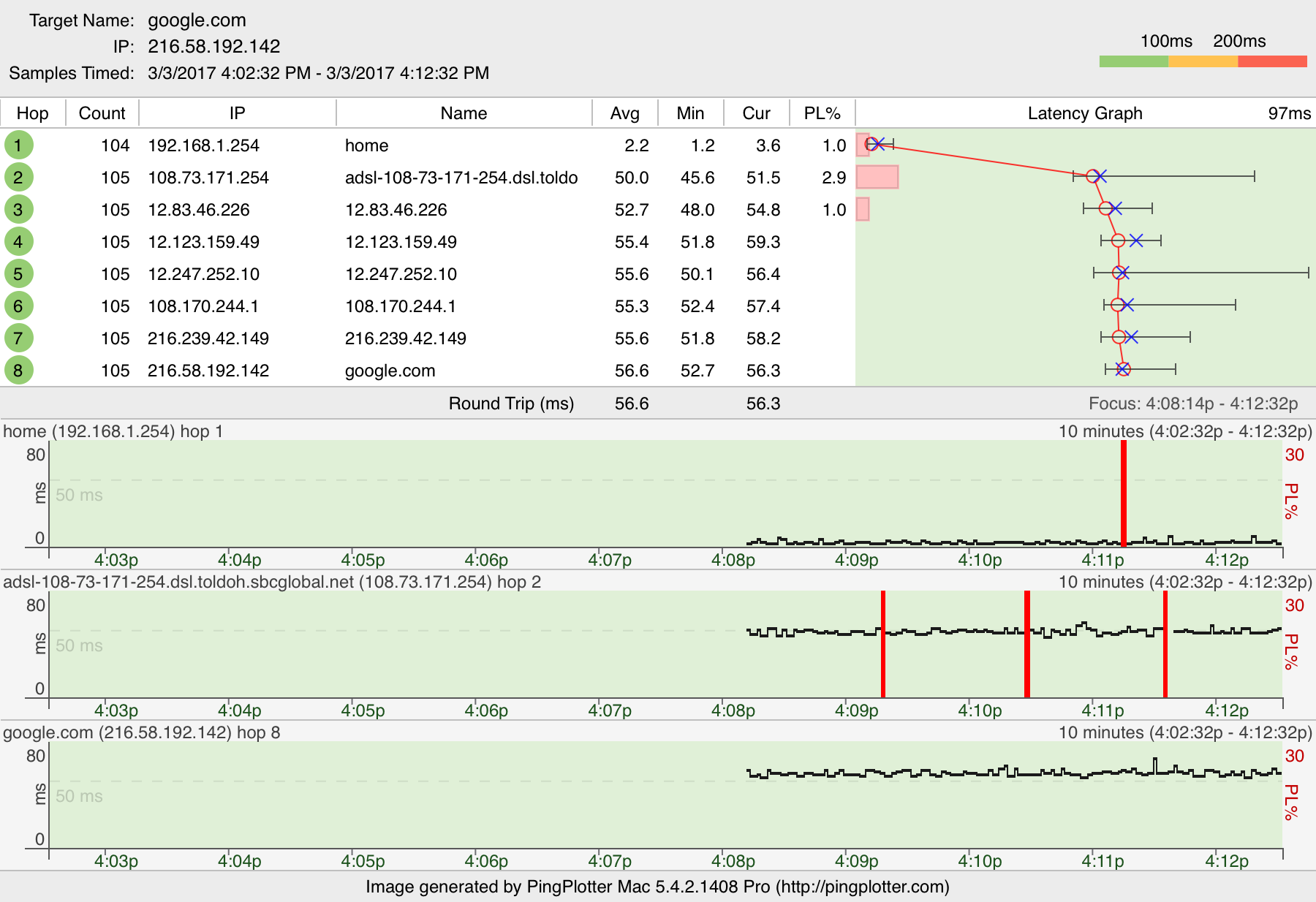

Thank you. I have included three of them. Let me know if you need any more.
And to answer your question, yes, the high latency and packet loss are carrying through all the way. I have looked at some of the pictures on your site, and none of them look exactly like what I am seeing.
