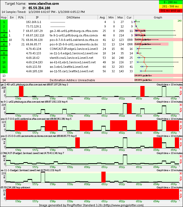

#1977 - 02/05/08 07:10 AM Re: Need help comprehending this [Re: atttaboy]
This screenshot doesn't really include enough information for us to do a good job of troubleshooting. I'd start out by using this technique:
http://www.nessoft.com/kb/47
If you do that and don't see the problem, try following the instructions earlier in this post - collect a bunch of data and email that to our support team.
