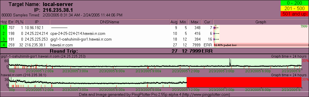

I am uploading an image of PP at the exact time on Feb 23 that local server again became unreachable. The graph shows 33% packet loss just before the 100% loss.
