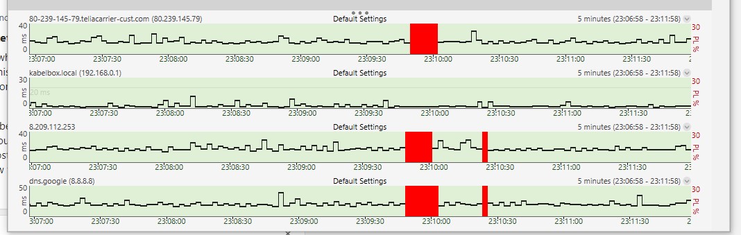

Recently my GF has had some latency in FFXIV, which seemed like packet loss. I did some tests, using 2 different PCs for a couple of games and they both experience packet loss at the same time, even on different games. We are also both connected via ethernet cable.
I downloaded ping plotter and added the IP address of a few games, google (8.8.8.8) and then also our router (192.168.0.1)
The packet loss seems to be almost uniform amongst all other than the router; as you can see in the screenshot attached. Does anyone have any idea why this might be or how I can go about potentially fixing this? And also what it means when all 3 have packet loss but the router here doesnt?

Based on the screenshot you included it would appear that this network issue your GF has been experiencing is likely originating at the ISP. You can come to this conclusion because the trace to your router shows no packet loss while all 3 of your traces to external targets exhibit packet loss.
