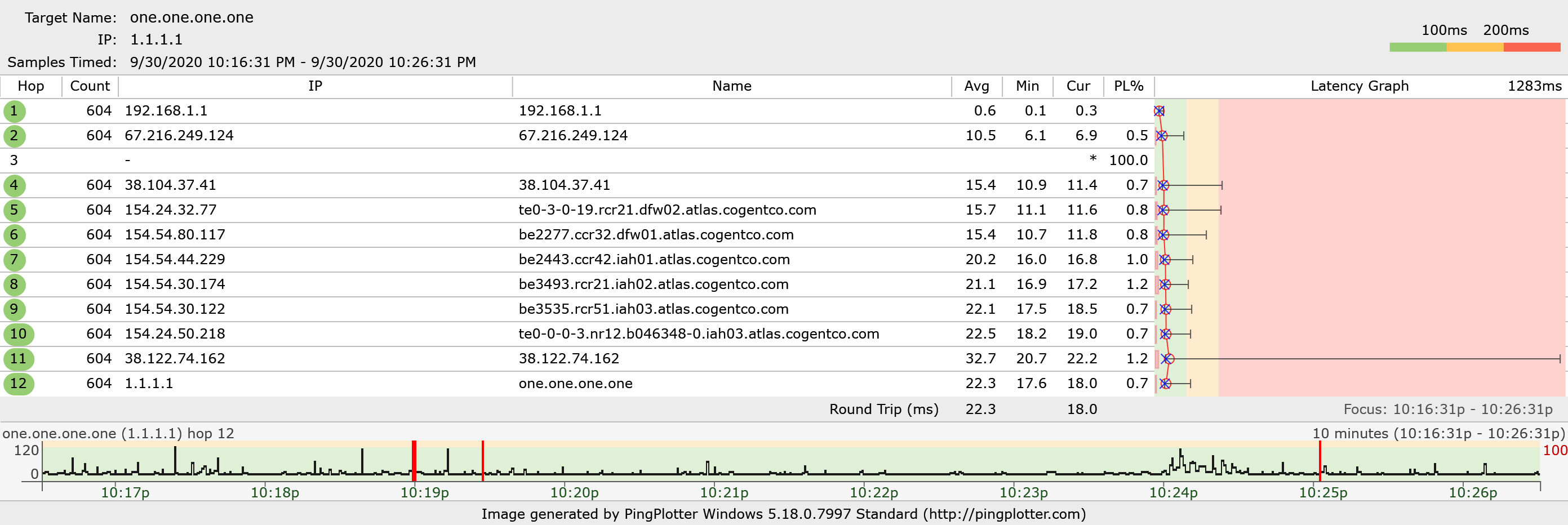

It sounds like you've tried a lot of different approaches and have not had much success. I can imagine feeling pretty frustrated if I were in your situation. I'll do my best to help you out and see if we can get to the root of the issue.
The approach that we recommend is to gather some data, interpret the data, and then formulate a plan based on the analysis.
From the image you attached it looks like you have already gathered some good data using PingPlotter. From the 10 minutes of data that it shows I see that there is low level packet loss that starts at hop #2 (67.216.249.124) which (after a quick WHOIS lookup) looks like it's your ISP (Gilmer Etex Communications Llc). While your graph only shows low levels of packet loss (0.7%) it also only shows 10 minutes so if you zoom the time scale out I'm guess you'll see more. Any consistent packet loss like this, even at low levels, could cause issues with games and live streaming.

I would suggest gathering some more data (maybe you already have) that documents these times of packet loss and how often you see them. I'd try to correlate when you're experiencing the issues with your games to what you're seeing on your PingPlotter graphs. Write up the issue and present the data that you're seeing (consistent packet loss over time starting at 67.216.249.124).
