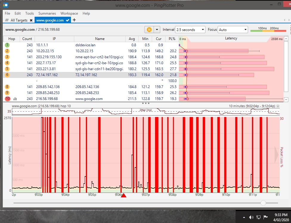

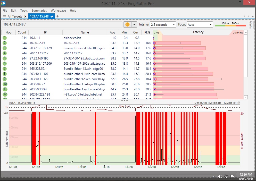

I am getting a lot of packet loss on the second hop. It always starts on the second hop and it carries right through to the end every time. It isn't constant, but it's very frequent (often every few minutes or so). There are usually a few devices connected to the router, but the issue remains even if just one is using it. It isn't unusual for the packet loss to end up reaching over 80% loss.
For the last 3 months (when I moved to this property) my connection has been barely usable. So far my ISP have had me do a lot of power cycling and turning things off and on again and yes I'm sure it's plugged in. It's connected via ethernet cable. They sent me a new router about a month ago and it didn't do anything different. Today they said the next step was to send me a new router... That was when I had had enough, clearly they are not listening as they already did that and it didn't work! I asked what the next step after that was... they didn't know...
Anyway, so hopefully I've added a couple of images to this post so you can see what I'm talking about and someone can point me in the right direction so I can point them in the right direction!

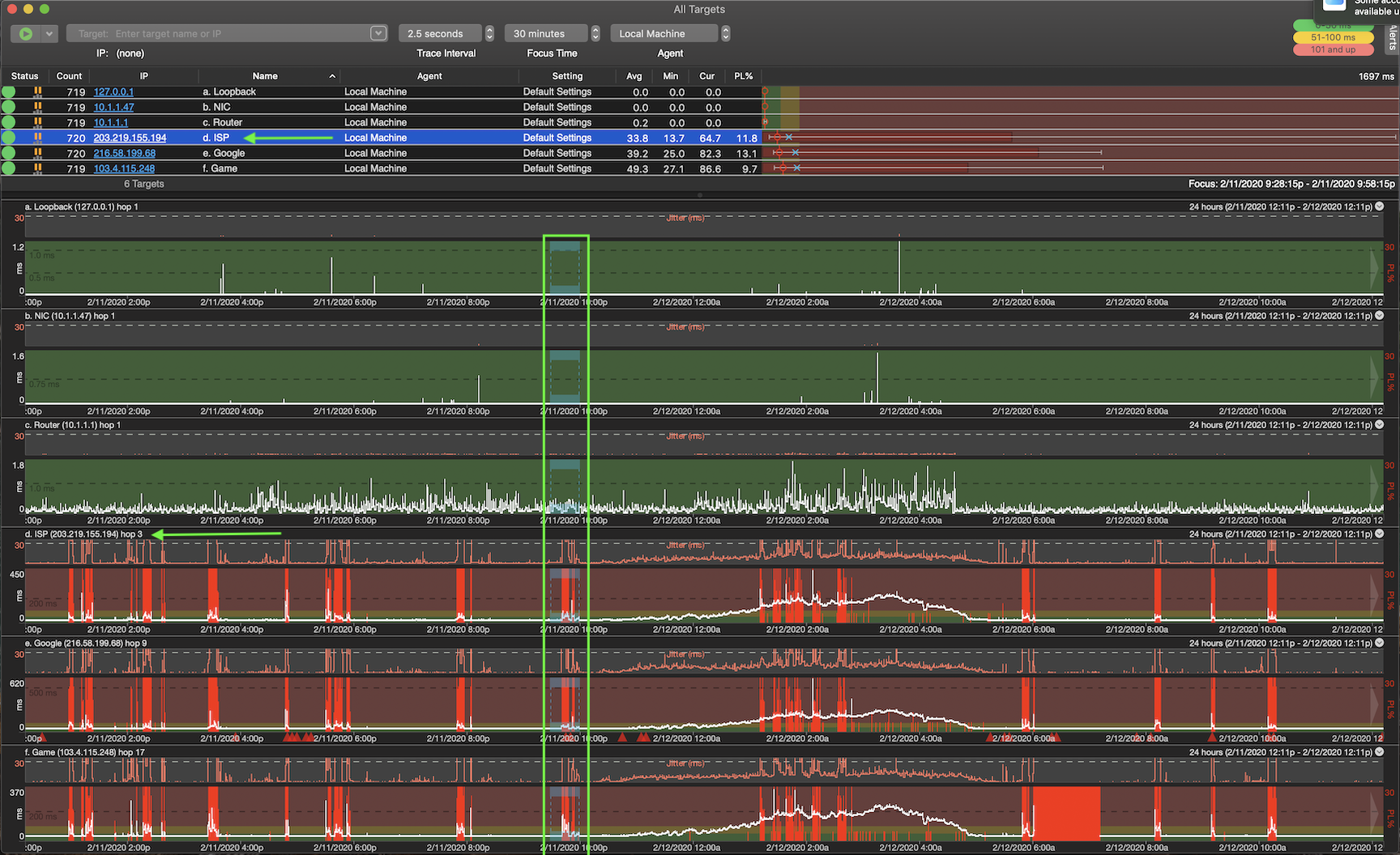

OK, so those traces have finished and I've got the links to the share pages... I hope I've done this right!
I'm confused as to why when I've traced all these things at once that I have so much packet loss showing up on the first hop when that has never been where I've had packet loss showing before? But the trace that goes just to that first hop shows none.
My ISP are still being ridiculous... the last contact I had with them was yesterday and they asked me for the same information I gave them 2 weeks ago... urrrgh!
Trace to the router
Trace to NIC
Trace to loop back address
Trace to my ISP
Trace to google.com
Trace to game server
ETA: I also don't know why it's showing from dates before I restarted these traces... I thought all that information got lost when my trial initially ran out.

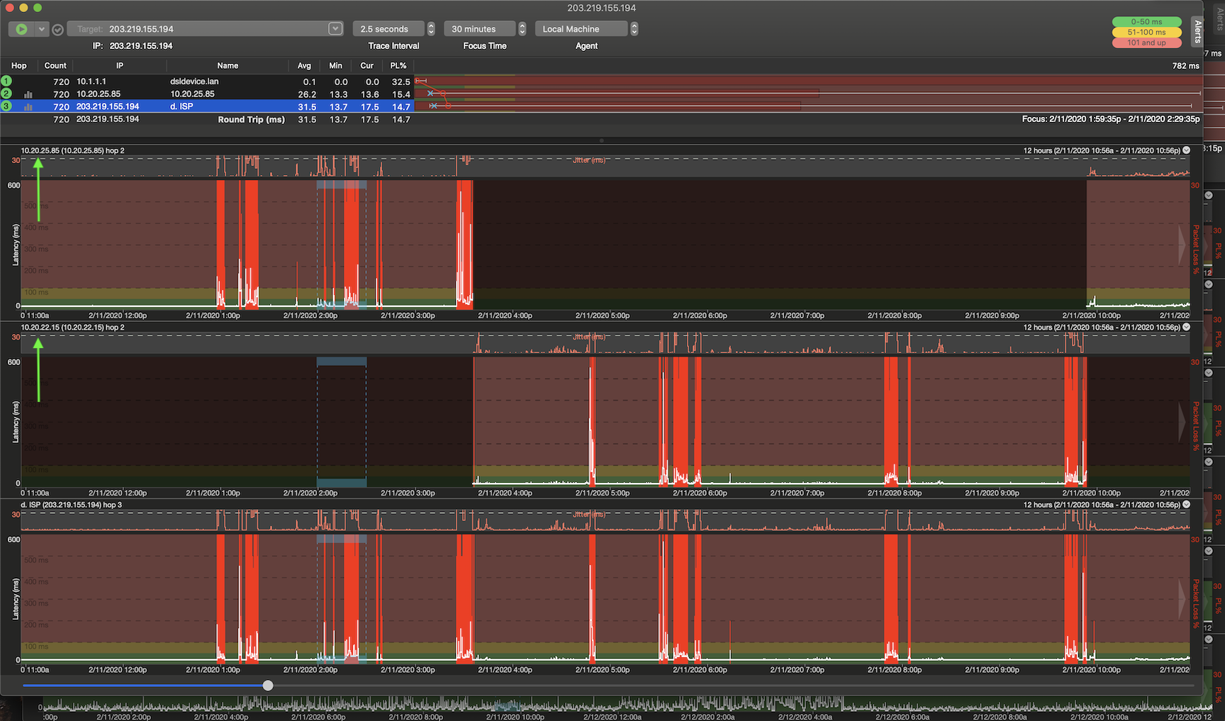

This stuff is providing a much clearer picture now. Hop #3 seems to be a clear culprit, but when you dig deeper and compare the graphs on the trace to your ISP, there are 2 IP addresses at hop #2 which exhibit the problem. (see attached images).
In regards to the packet loss you're seeing at hop #1, it's likely that your device is just down-prioritizing ICMP Echo Requests where TTL = 0. This is fairly common and doesn't affect your connection.
When the Pro Trial conversion to Free happens, this only limits what you can do in the GUI of the application. Sessions will indeed stop, however, the trace data will not be lost and can be re-loaded as soon as Pro is activated again.
In conclusion, I would recommend investigating the IPs at hop #2 and show your ISP this data!
