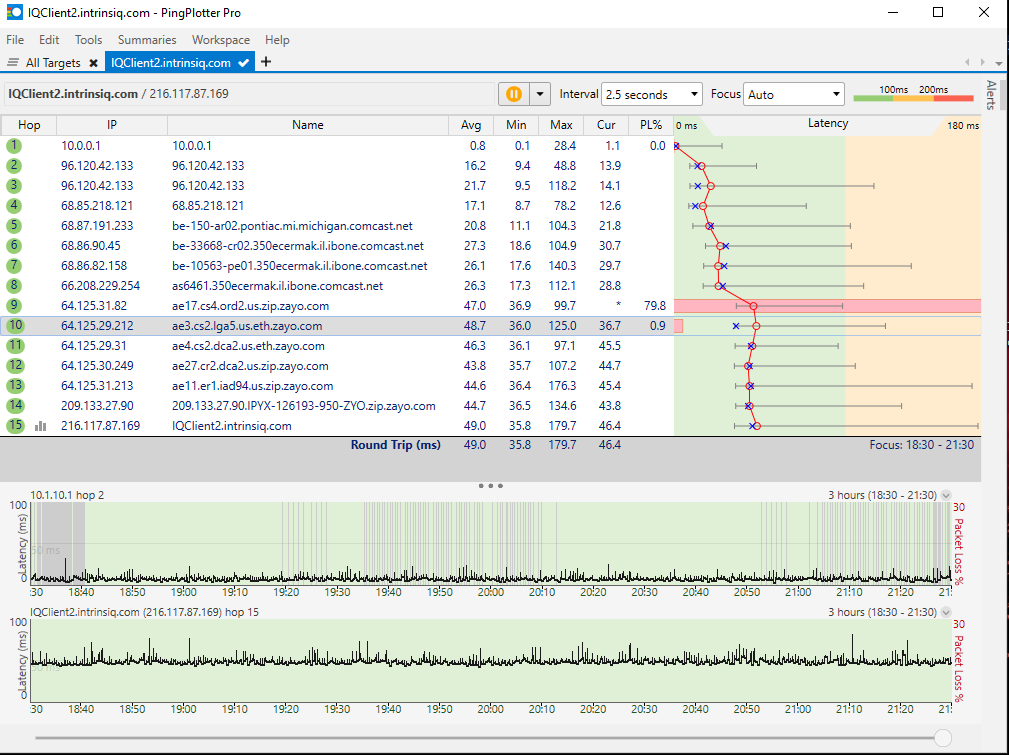

I need some help understanding the gray periods in the timeline graph. I have read the article at the following URL, but I'm mystified at all the gray periods that keep appearing on the second hop (the ISP's gateway/modem) and ONLY on the second hop. I have seen brief gray periods on other hops occasionally, but not very often. Also, I've tried changing the trace interval and setting the Packet Send Delay, but nothing seems to help. I do not recall ever seeing this problem before the last upgrade to 5.11.5.6618.
https://www.pingman.com/kb/article/gray-periods-in-the-timeline-graph-30.html
Pingplotter, 2019100859.PNG (240 downloads)
IQClient2 201910060859.zip (54 downloads)

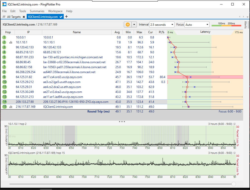

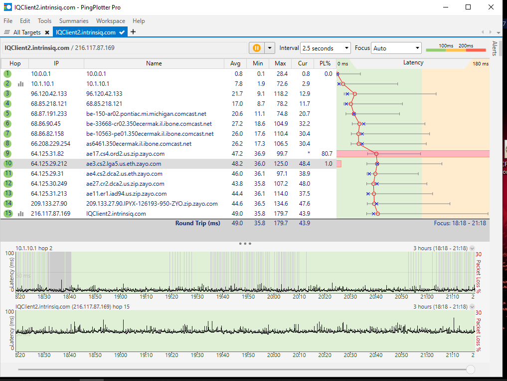

Poe, Thank you for the response and direction. I just submitted the support request, and while I was preparing it, I noticed Hop #2's IP address was randomly switching from 10.1.10.1 to the same IP as Hop #3 (96.120.42.133) which is apparently the reason for the gray periods I've been seeing. So now my question is, "Why is Hop #2's IP address changing to the IP of Hop #3?" Screen captures of both situations are included for clarification.
PingPlotter Gray Periods, 2019102118.PNG (280 downloads)
PingPlotter Gray Periods... IP changing, 2019102130.PNG (193 downloads)

It is indeed some very strange behavior. Without knowing more about how your network is configured it's hard to say for sure but it looks like there may be an issue with your router setup. 10.0.0.1 and 10.1.10.1 are both internal private IP addresses and that's where the weirdness is happening. You are getting the gray lines because PingPlotter isn't expecting anything to be there. When it switches over to the 96.120.42.133 IP then you get a brief instant of graph tracing and then it switches back.
The 96.120.42.133 IP address belongs to Grand Rapids Comcast Cable Communications Llc so that's your ISP. It may be something with how your cable modem is configured. You could do a factory reset on it and see if it solves the issue. If that doesn't help, if you lease the modem, I would encourage you to ask for a replacement unit.
