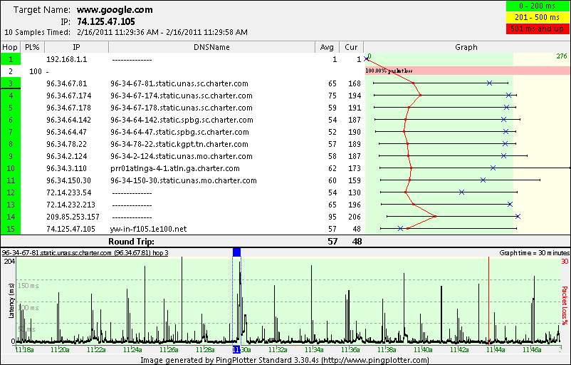

I got some interesting results! With both computers connected wirelessly to the router I see spikes of 200 Ms pinging the other computer. This happens approx evey 10 seconds. I don't think this is good or normal. When both are connected wired to the router it bounces between 1 and 0 pinging Evey second.
I was hoping it would happen when wired directly also as the main problem I have been experiencing is poor gameplay on my Xbox which is wired.

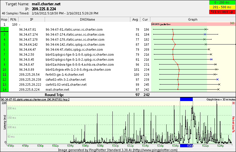

So based on this, you should make sure the data you collect with PingPlotter is using wired - if you use wireless, you're going to be adding some local network latency that your Xbox isn't seeing. Were you wired or wireless when collecting data in the first post here?

The first result from above was wired directly to the modem. The second result was through the router, probably wirelessly but I do not know for sure. I need to keep better track.
I am going to get some better data from pingplotter wired directly to the modem. I only have a laptop and a netbook so it takes a little more effort to get long term data.
