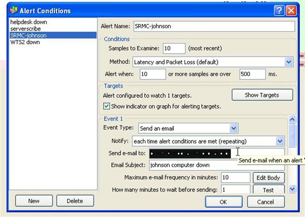

#2254 - 02/02/11 09:55 PM mail tests ok, no alert email when condition met
bryceuser Offline
Registered: 02/02/11
image is attached. mail tests ok. IP address for target is correct. please see image. What setting is wrong?
It is not alerting me when I pull the plug on this target computer.
send email is selected
each time conditions met selected
email is correct for sending "to"
pingplotter (Large).jpg (255 downloads)
#2255 - 02/02/11 09:58 PM Re: mail tests ok, no alert email when condition met [Re: bryceuser]
The most typical cause for this problem is when the alert is not tied to the target being monitored. Have a look here for more information:
http://www.pingplotter.com/manual/standard/troubleshooting_alerts.html
If that's not it, please let us know.
