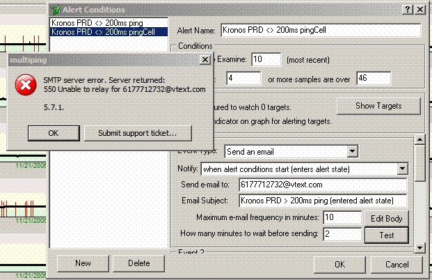

Just a followup: when trying to "Test" the vtext message by itself I recieved the following error.

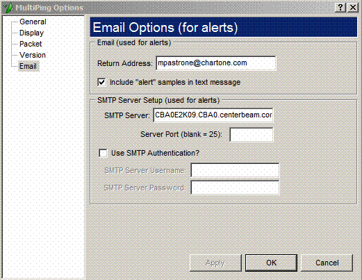

Here is my Email setup.

Sorry for the self-diagnosis, but after entering the SMTP authentication creds, the vtext email now reaches my phone OK.
