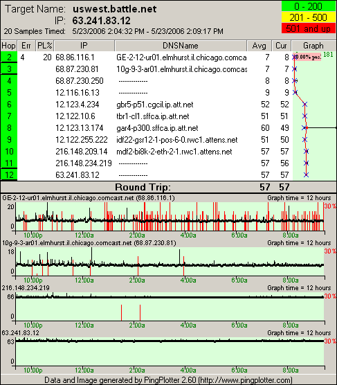

Pete,
I opened PingPlotter just now to check the overnight TCP data coming from Battle.net, and there are breaks in the lines of graph, as shown in the image below. I know these are where the red bars showing 100% packet loss should be, so I'm posting this more as a bug-report/FYI to you rather than an actual question. I can email you the full data set I just saved, if it would be helpful to you.
Susan

#1630 - 05/23/06 02:00 PM Re: Broken lines in the graph [Re: Galaxiana]
We've seen that a few times - and it's usually because of negative latencies (pretty impossible unless the clock on the computer changes, I'd think, but ...).
Go ahead and send us the sample set and we'll have a look.
Pete
#1631 - 05/23/06 02:33 PM Re: Broken lines in the graph [Re: Galaxiana]
Actually ... I thiink I was totally wrong in my analysis of the problem.
I suspect that you actually turned off the option to graph packet loss. Turn that back on at Edit -> Options, Display, Packet Loss Scale at 30% (or some other number if you prefer a different scale - 30 works well, though).
If that's not currently on "Don't graph packet loss", then send the save file and we'll look further.

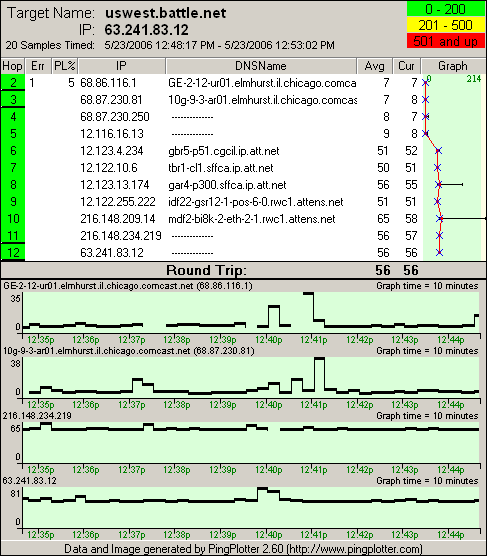

Oh yes! You're right! I turned off that option because I didn't understand why some of my red lines go only halfway up, and others go all the way up, even though both represent 100% packet loss, when viewing the graph in longer time frames. I tried turning off "graph packet loss" in an effort to comprehend this better, but I didn't have time to finish reading all of your wonderful tutorials and knowledge base articles to see if they answered my question. The half-lines I am referring to are like this 12-hour image below (with graph packet loss 30% turned back on).
Sorry for the confusion, and again, I am sooooooooo grateful for your time and help!

#1633 - 05/23/06 04:05 PM Re: Broken lines in the graph [Re: Galaxiana]
We have a knowledge base article that should answer your question on time graph packet loss height:
http://www.nessoft.com/kb/20
