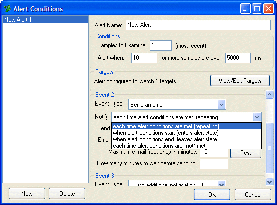

As for your alert events - the "Notify" dropdown on each alert event will let you pick "when alert conditions end" - which will make that event (an email in your case) happen when that target goes back up. Have another event on the same alert for "when alert conditions start" to get a notification when that target goes down, and then again when it goes back up.

However, I can't find the "when alert conditions end". I'm running the latest version so is it something that gets unlocked if I buy the license?

Make sure you're looking in the right sction. It's in the "Notify" section after you select your event type. I've attached a screenshot.
Let us know if this doesn't help you track down the right setting.

Ah it's because I use the tray icon notification and not the e-mail one. I have MultiPing installed on my computer and to me the best and fastest way to get alerted is by the tray icon.
