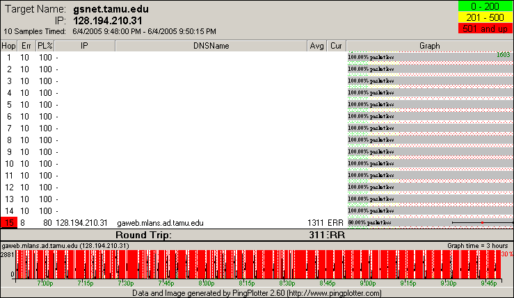

I switched the TCP packet type & tried again.
Things look basically the same from home:
but at work, things look kinda bad!
(sorry for the resolution-I was using my remote desktop connection for that one, as I'm not at the office!)
Does this shed a different light on things?
I will let it run for a while at work & see what happens...

After changing the packet type, etc., I ran it for 3 hours & my results now appears in my previous message.
Any suggestions?
#1395 - 06/06/05 12:24 PM Re: Can access form home, but not work... [Re: texan767]
For being from the same provider, those graphs sure look a *lot* different. One interesting component here is that the results from PingPlotter have similarities to the way the site behaves for you - timeouts, big lags, etc.
